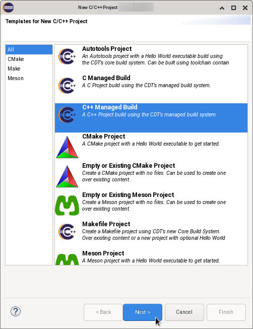

Step 1: Creating a project
- Select File > New > Project.
- Select the type of project to create. For this tutorial, expand the C++ folder and select C++ Project and click Next.
The C++ Project wizard opens.
By default, the CDT filters the Toolchain and Project types that it displays in those lists based on the language support for the C++ Project wizard you selected for this tutorial.
- In the Project name field, type a name for the project, such as HelloWorld.
- From the Project type list, expand Executable and select Hello World C++ Project. This project type provides a simple Hello World application in C++, and the makefile is automatically created by the CDT.
- Select a required toolchain from the Toolchain list.
A toolchain is a set of tools (such as a compiler, linker, and assembler) intended to build your project. Additional tools, such as a debugger, can be associated with a toolchain. There can be several toolchains available, depending on the compilers installed on your system.
- Click Next.
