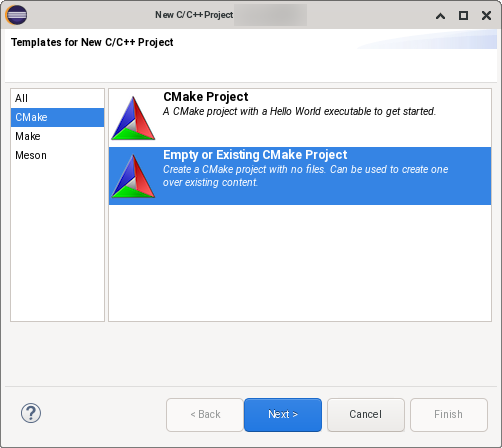

To create an empty CMake project in CDT select the template Empty or Existing CMake Project in the New C/C++ Project wizard.

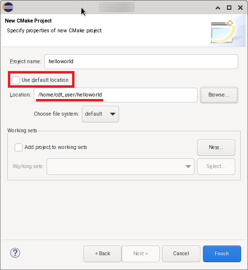

In the New CMake Project wizard uncheck Use default location and set the location of the existing code.
Existing code CMake
More information about creating a CMake project is described in Creating a CMake project

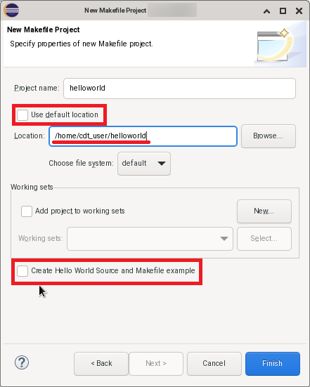

Create a CBS Makefile project in CDT as described in Creating a Core Makefile project with the following changes:
In the New Core Makefile Project wizard uncheck Use default location, set the location of the existing code, and uncheck Create Hello World Source and Makefile example.
Existing code Makefile
