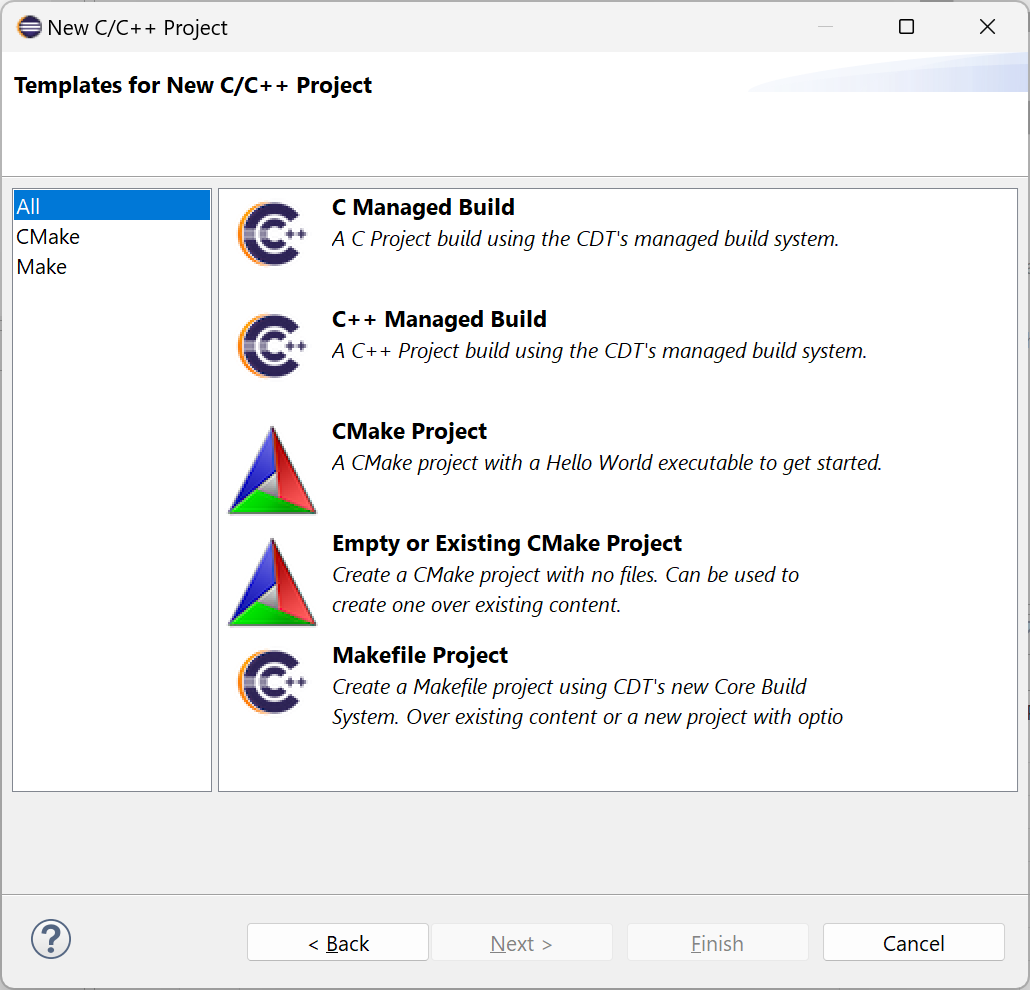

By default, the CDT presents all C/C++ Project templates.

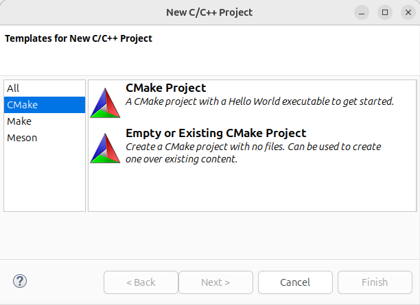

  1. Select the CMake template filter and choose from the following CMake project templates:
    c cpp project wizard cmake
    • CMake Project - provides a simple C++ Hello World executable application project with main() and a supporting CMakeLists.txt file.
    • Empty or Existing CMake Project - provides an empty executable application project suitable for importing existing source and CMakeLists.txt files.
  2. Click Next.

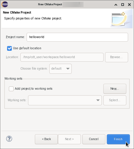

  3. In the Project name field, provide a name for the new project.
  4. Leave the Use Default Location option selected.
  5. Click Finish.
  6. If a message box prompts you to change perspectives, click Yes.
c cpp project wizard cmake properties
Your new project displays in the Project Explorer view. Your project may be empty because you have not yet created files for your project. You can now start writing the code for your application or importing code from elsewhere.
