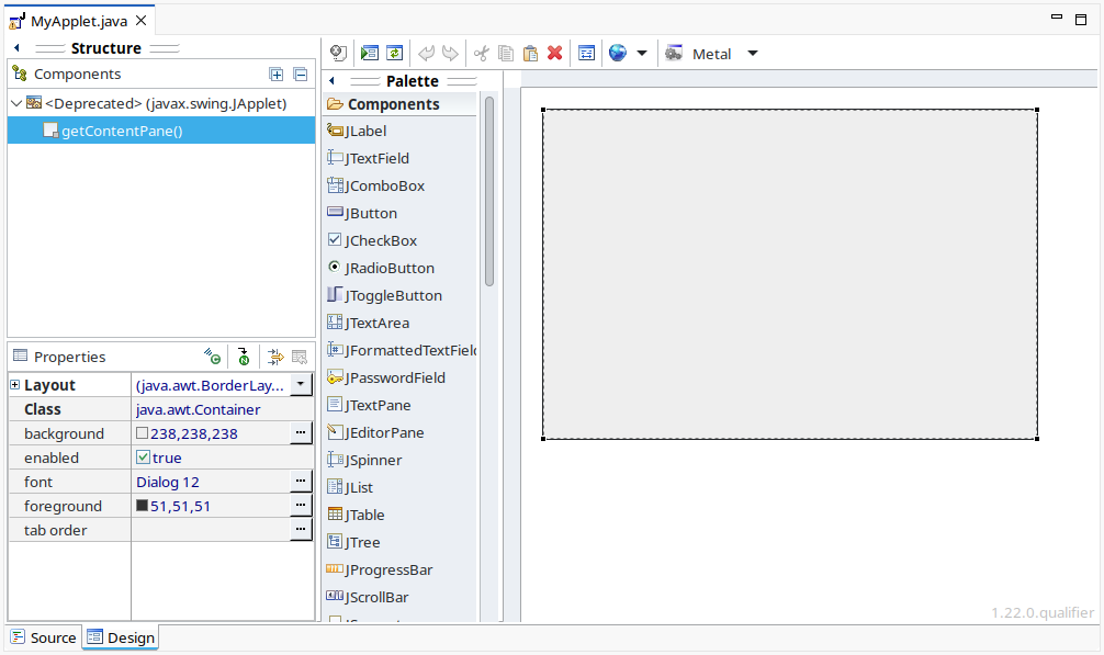

  • Deprecated support for Applet/JApplet
The Applet API has been deprecated for removal with Java 9 and formally been removed with Java 26. Support for those containers will be removed after the 2027-12 release.
When opening a JApplet with the editor, the root element will be annotated with <Deprecated>
Deprecation indication in Designer editor

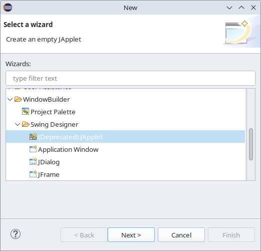

When trying to create a new JApplet with the editor, the entry in the "New" wizard and the dialog tile will be annotated with (Deprecated)
Deprecation indication in "New JApplet" wizard

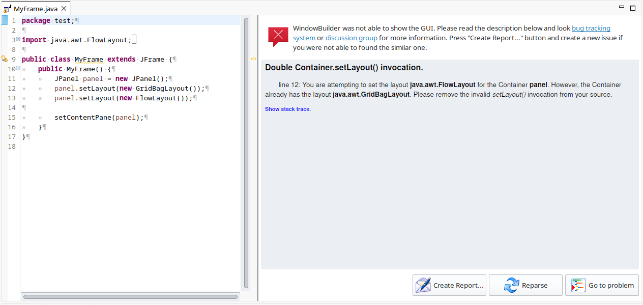

  • New error code 1003 if multiple layouts are added to a container
This aligns the behavior of the Swing designer with the behavior of the SWT designer. Adding multiple layouts to a composite is generally not supported and causes issues when working with e.g. the GridLayout.
The parser now detects such cases and throws an appropriate error message.
Swing snippet with two 'setLayout()' calls and the error message
