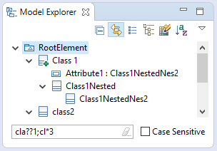

Search field in Model Explorer
You can use:
? for any character
* for any string
; is used as OR
^ is used as start key
$ is used as end key
A case sensitive option is available (use Aa checkbox)
