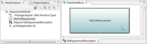

To apply a profile, first you need to open your model.

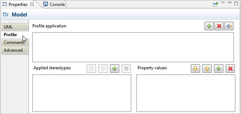

The first step consists in selecting the part of the model you want to apply the profile on. Profiles can be applied either on Models or Packages. Then to apply the profile on this part, let’s select the profile tab in the property view, and press the Apply Profile button.
Select Package
Profile Tab
Apply Profile

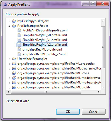

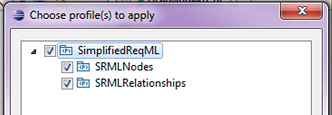

Then, Papyrus will ask you firstly to choose the profile to apply from your workspace, and secondly to choose which part of the selected profile you want to apply. It is indeed possible that your profile may be composed of sub-profiles as explained in the previous chapter. It is then possible to apply partially a profile by applying one or more of its sub-profiles.
Select Profile
Select Profiles

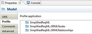

Your model should now look like this:
Applied Profiles

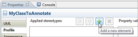

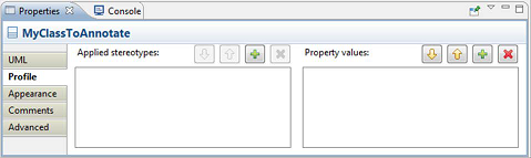

To annotate a model element, you first need to select it either through the model explorer or in one open diagram. Then, select the tab named “profile” in the properties view, and add your stereotype using the Apply Profile button of the widget named “Applied stereotypes”
Apply Stereotype
Apply Stereotype
Apply Stereotype

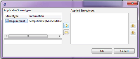

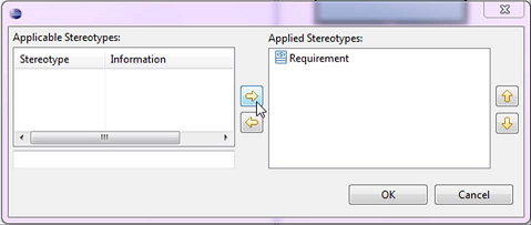

A dialog box enables you to select the stereotype(s) you want to apply (left part of the dialog box) and using the Add button located in the middle of the dialog box enables to define which stereotypes have to be applied. The list located on the right of the dialog box denotes the list of applied stereotype. If you want to unapply stereotypes, you can select those latter from the right list and use the Remove button to unapply them.
Apply Stereotype
Apply Stereotype

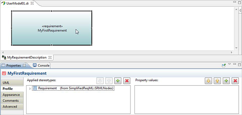

At this point, your Papyrus should look like this:
Applied Stereotype

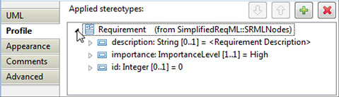

As already mentioned, Stereotypes may have properties. Consequently, when applying a stereotype to a model element, it may be necessary to set the values of those properties. For that, you will go to the profile tab of the properties view and then you can unfold the stereotype application as shown in following figure:
Stereotype Properties
Once you have selected the property to edit, its value (if already set, as for example if there is a default value defined in the profile for the property) appear in the right part of the property view. If the property has not yet been valued, you can add a value by using the Add button located on the top right of the widget named “Properties values”. If there is a value, double-click on the value to edit this latter.
Edit Property
Ps: If you want to delete a value set to property, let’s use the Delete button located on the top right of the widget named “Properties values”.
