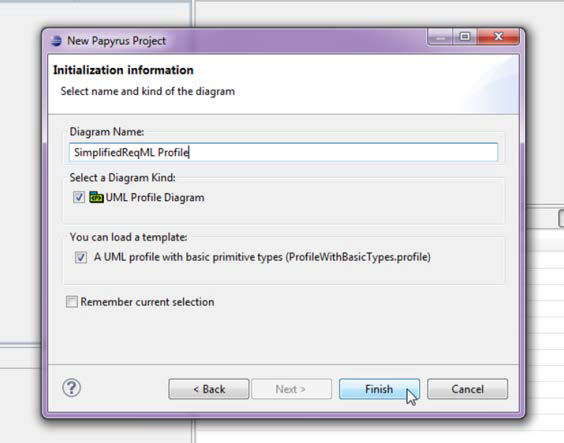

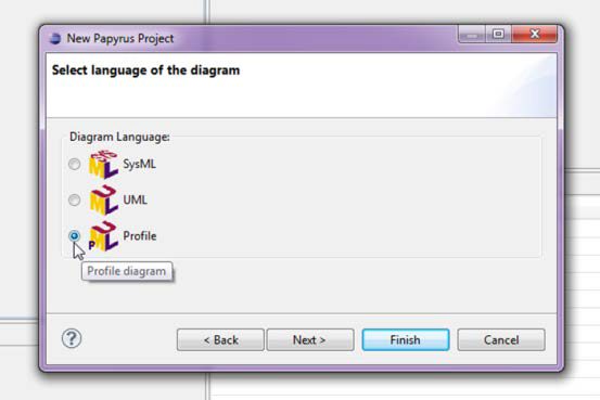

To create a new Profile, select File > New > Papyrus Project (Or Papyrus model, if you already have an opened project). When asked for a Diagram Language, Select "Profile":
New Profile
New Profile Diagram

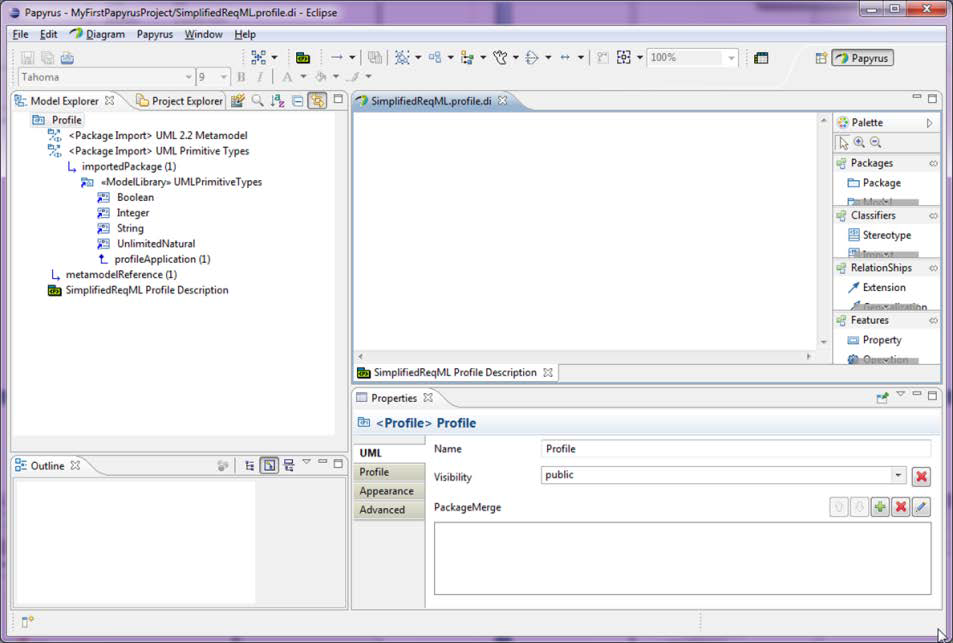

Profile Editor
This creates a Resource containing a uml::Profile as root element.

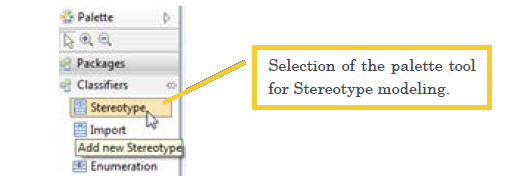

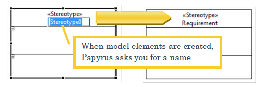

A stereotype is created as any other UML model elements in Papyrus: select the related tool in the palette of the profile diagram editor, and then click in the place you want to create this element on the background of the diagram. If the palette is not open, just click on the small arrow on the upper right corner of the diagram editor. Papyrus will then ask you to provide a name. Once done, hit the return key and that all.
Stereotype Palette
Stereotype Name

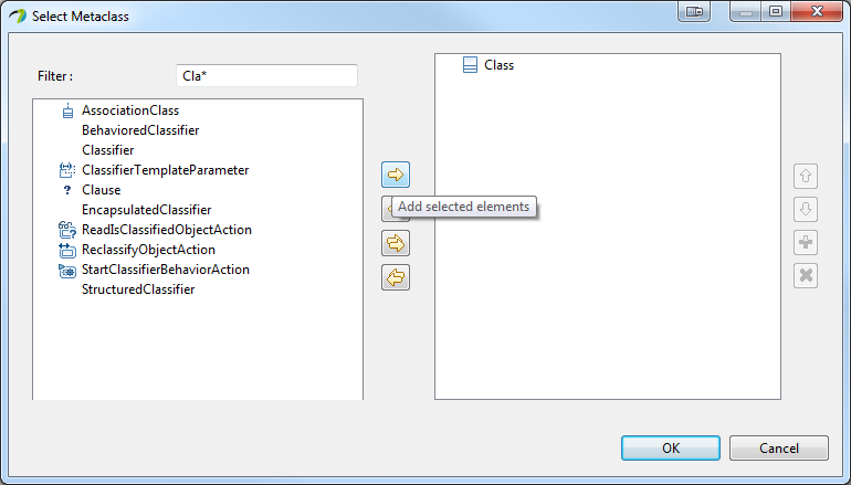

Once you have created a stereotype, you need to import the UML2 metaclasses you want to extend. First, you have to select the tool “Import Metaclass� within the palette of the profile diagram editor. Then, let’s click on the profile diagram where you want to drop the imported metaclass. A Papyrus dialog box is then opened in order to ask you to specify which metaclasses you want to import. Select the metaclasses in the left list and either drag and drop these latter in the right list or press the button with arrow directed from left to right and located between both aforementioned lists. Then, let’s press the button “ok� and it is done. The imported metaclasses are then shown in the diagram as illustrated.

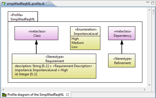

Once the stereotype is created and the meta-class is imported, you may then model the extension relation from the stereotype to the meta-class as shown in the following figure. The extension relationship is modeled using the extension tool in the profile diagram palette, Extension. Within the diagram shown in next figure, both stereotypes «Requirement» and «Refinement» extend respectively both meta-classes Class and Dependency:

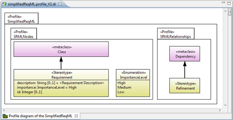

Some profile may be complex due as for example to their scope that may be large. In order to cope with this complexity, it is then possible to decompose a profile into a hierarchy of subprofiles. A subprofile behaves such as a sub-package; it is a container of stereotypes.
To create a sub profile, select the profile tool in the profile diagram palette ( Profile) and then click on the profile diagram where you want to create your new profile.
In the example denoted below, we have created two sub-profiles of the SimplifiedReqML profile in order to gather in one hand the extensions that apply to node elements of the models and in the other hand the extension defined in the DSML for modeling relationships between those nodes:

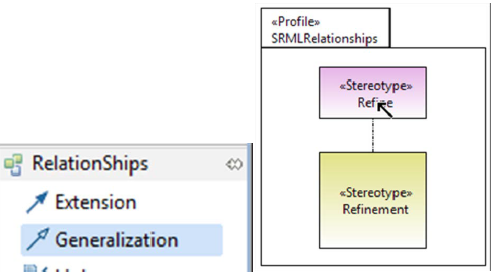

To create a stereotype generalization using the profile diagram editor, let’s draw a generalization relationship using the tool Generalization from the palette. As any relationship within Papyrus, you need to click first on the source and then on the target of the relationship you want to model.
In our example, there exists in the UML predefined profile a stereotype extending the dependency relationship in order to introduce the concept of refinement: «Refine». Consequently, we will redesign our sub-profile SRMLRelationship in order our stereotype «Refinement» to be a specialization of this UML stereotype instead of directly extending the UML dependency meta-class.

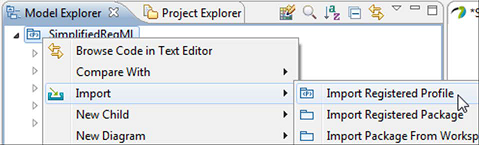

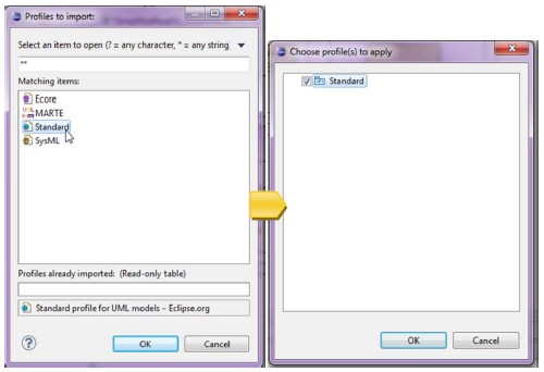

As previously mentioned, you may extend a stereotype defined in your profile or a stereotype defined in another external profile. In the latter case, the first thing to do is to import the profile where the stereotype has been defined, as denoted in the following example:
Import Profile
Select Profile

Now, let’s draw the generalization relationship from your stereotype (e.g., «Refinement» in the figure below) to the generalized stereotype (e.g., «Refine» in the figure below).
Generalize Stereotype
At this point, your diagram should look like something like the one shown here:
Result Profile

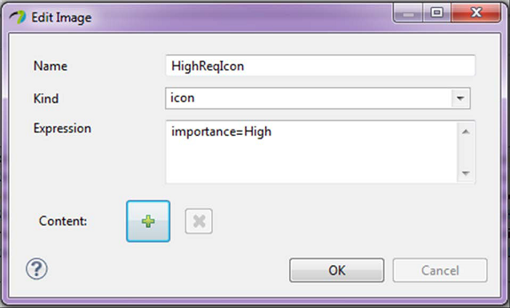

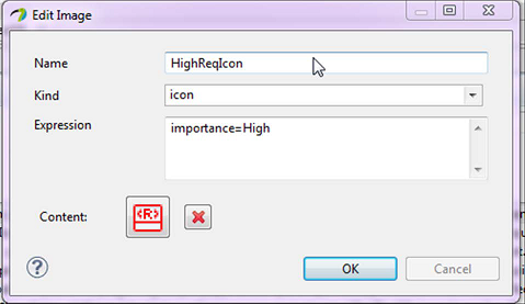

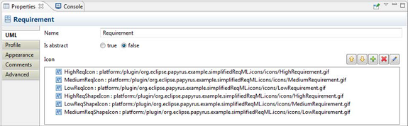

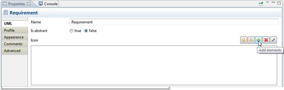

In order to specify the icons you want to attach to a stereotype, select the stereotype and the tab UML of the property view. In the right-upper corner of the widget named “icons�, press the button Add to add a new icon as shown in step 1. Once done, the dialog box shown at step 2 is open. Within this latter, let’s fill in a name and select an image file using the button Add defining the content of the icon. Next, you have to define the kind value: icon or shape. Using this property, you can choose to associate the selected image either as an icon or as a shape.
Step 1: Icons for Stereotypes
Step 2: Select Icon
It is possible to associate only one shape to a stereotype, but you can associate different icons to a same stereotype. In that latter case, there is a description property that is used to select which one to display. By default, if no expression is defined, the first one is the list is chosen for displaying. The expression has to be on a property of the stereotype which type is an enumeration type. In our example, we can set different icons to the stereotype «Requirement» depending on the value of its importance property. This latter is indeed typed by the ImportanceLevel enumeration which values may be High, Medium of Low (figure shown below). For this example, we will then associate the three following images High, Medium, and Low, to the stereotype «Requirement» and their related expression will be respectively importance=High (e.g. figure shown below), importance=Medium and importance=Low.
Many Stereotype Icons
