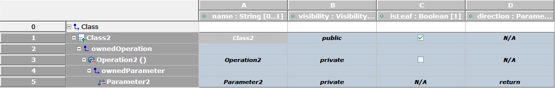

- PapyrusGenericTable : the type of UML Generic Table. This table is filled by DnD and accepts all UML Elements
- PapyrusSysMLRequirementTable : the type of the Table used to edit Requirement. This table is synchronized and shows only Class stereotyped by Requirements directly owned by the context of the table.

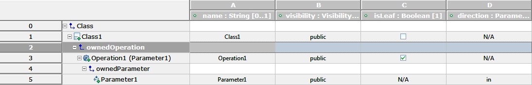

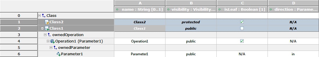

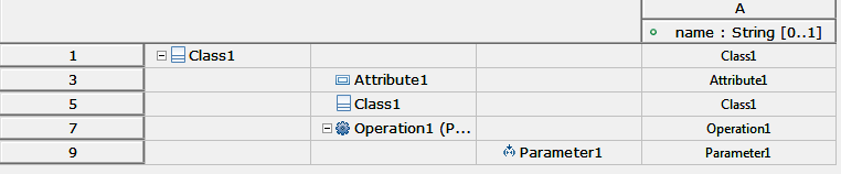

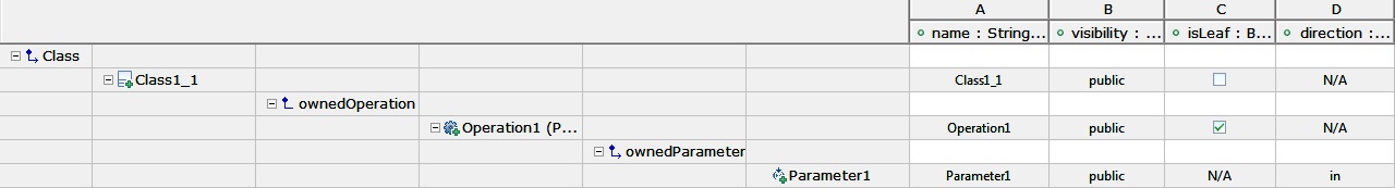

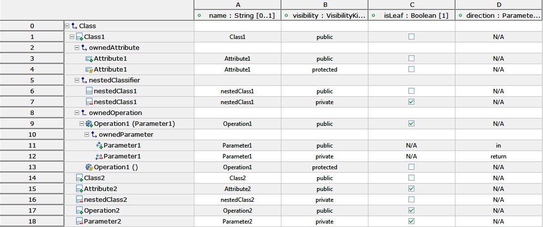

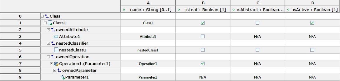

- PapyrusClassTreeTable : the type of the Class Tree Table. In this provided configuration, this table is fully synchronized. Its shows :
- on first level (depth=0), the classes directly owned by the context of the table
- on the second level (depth=1), the owned attributes, the owned operations and the nested classes of the classes displayed on the first level.
- on the third level (depth=2), the parameters of the operations dsiplay on the the second level

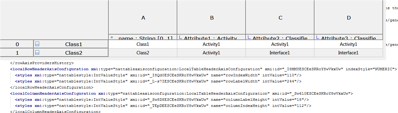

- Row Header :
- Index Row Header
- It can be hidden
- The index style can be changed, we can use letters : A,B...Z, AA, AB ... ZZ or numbers : 1, 2, 3...
- Label Row Header
- It can be hidden
- It is a single column in flat table
- It is composed by a single or by several columns in tree table
- The "name" shown in the label can be changed. The user can change the name of the element or create an alias in case of read-only element.
- The label's style can be changed by the user. The configuration feature depends on the kind of represented element. (name, icon, multiplicity, isDerived, type, ...)

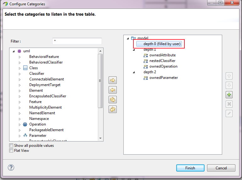

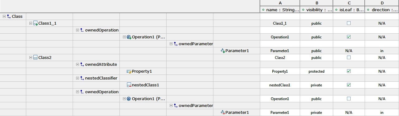

Tree Table and synchronization
The contents of the tree table is always synchronized, excepted for the first level (depth=0), which can be synchronized of filled by the user by Drag and Drop from the ModelExplorer, as for normal table.

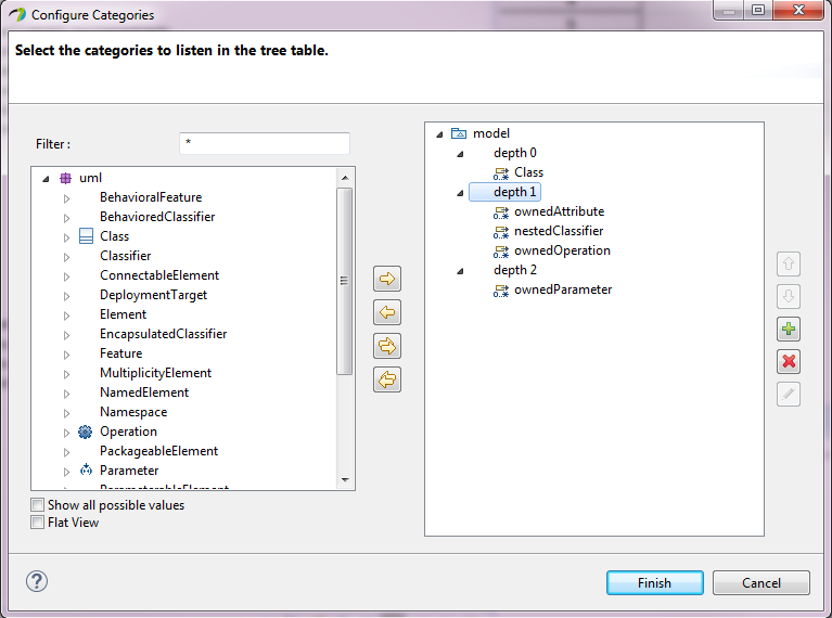

The Tree Table provides a way to choose :
- the filling of the first level (DnD or synchronization)
- the number of levels (depths) to listen and what to listen

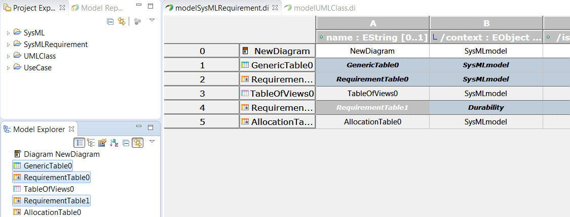

Some table snapshots
Existing Tables in small words

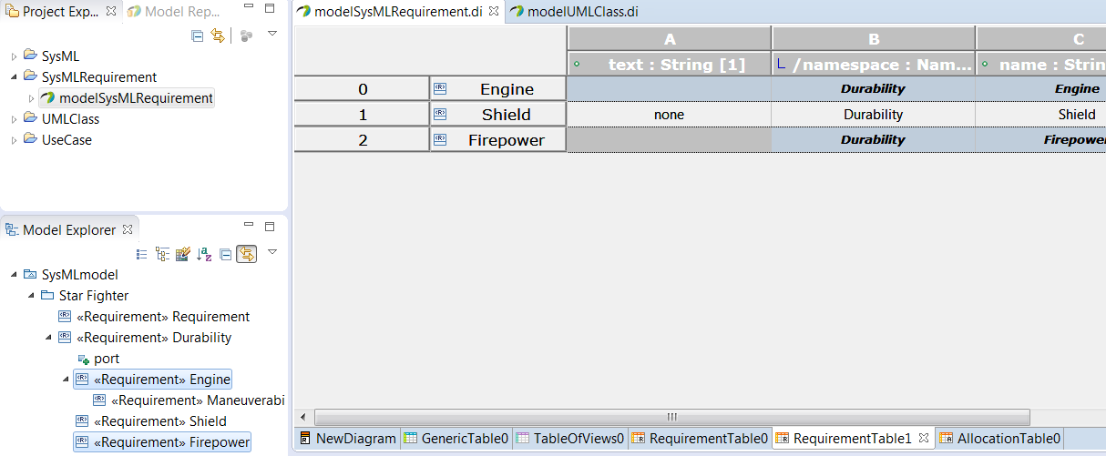

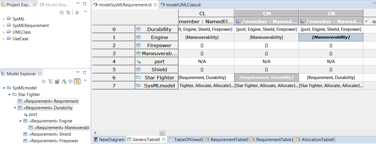

- UML Generic Table
- SysML Allocation Table
- SysML Requirement Table
- Views Table
- UML Class Tree Table

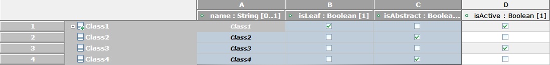

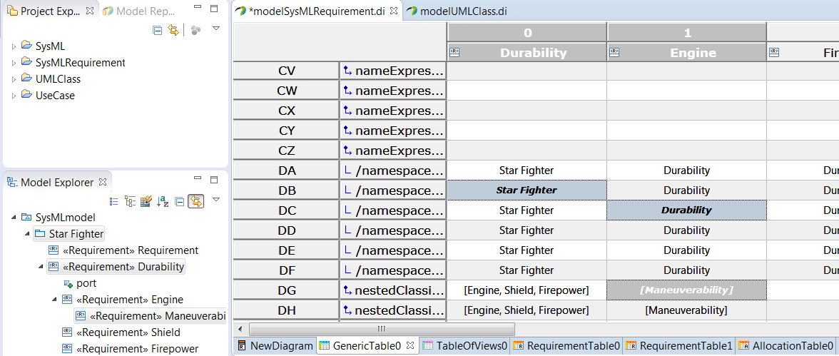

UML Generic Table
- This table is a flat table.
- Elements Accepted : UML Element only (all of them)
- Filling Way : User, by Drag&Drop from the Model Explorer
- Possible Context : all UML Element.
- Save : All rows displayed in the table are saved in the model
- Element Creation : All UML Elements

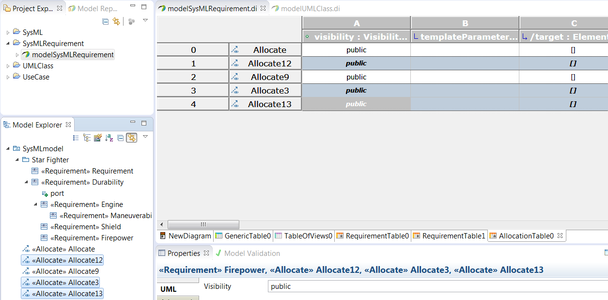

- Elements Accepted : SysML Allocation only
- Filling Way : Automatic, by Synchronization on the context of the model. Only the Allocation directly owned by the context of the table are displayed.
- Possible Context : UML Package, with the SysML Profile Allocations applied.
- Save : The Rows are not serialized in the model, because they are derived of the UML Model.
- Element Creation : SysML Allocation

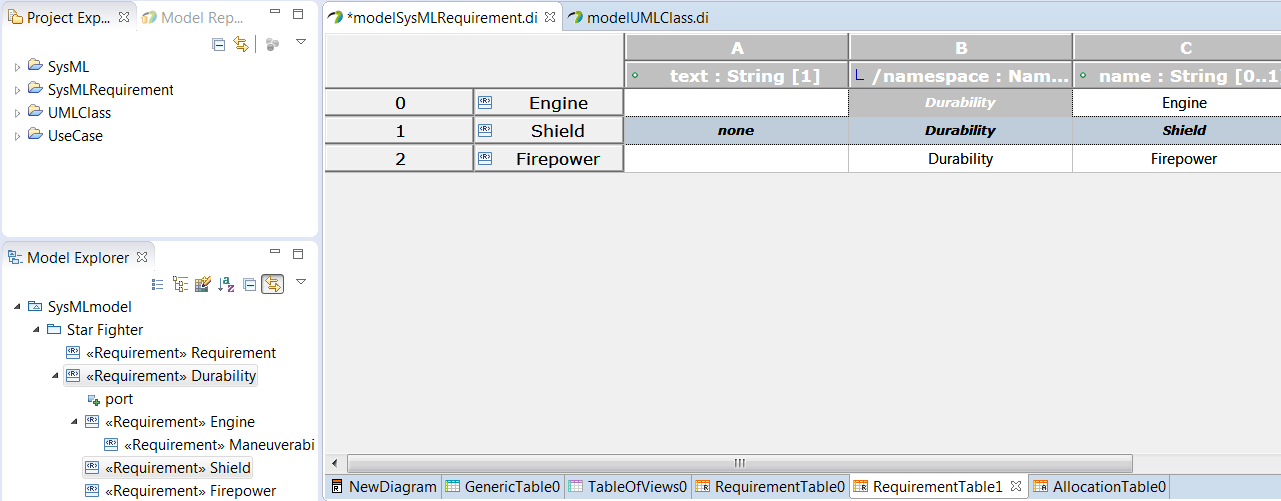

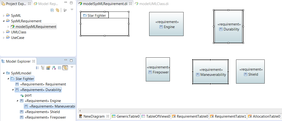

- Elements Accepted : SysML Requirement only
- Filling Way : Automatic, by Synchronization on the context of the model. Only the Requirements directly owned by the context of the table are displayed.
- Possible Context : UML Package, with the SysML Profile Requirement applied.
- Element Creation : SysML Requirement

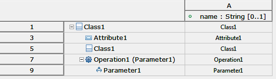

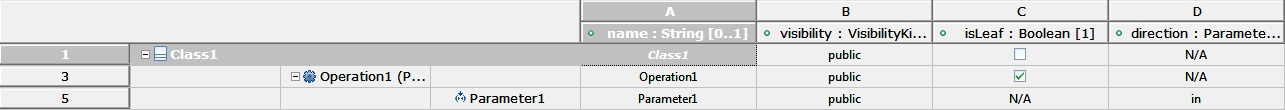

- This table is a tree table
- Element accepted : Classes (depth=0 and depth=1), Properties (depth=1), Operations (depth=1), Parameters (depth=2)
- Filling way : Automatic, synchronized on the context of the table
- Possible context : Package or Class
- Save : The rows are not serialized in the model, because they are derivied from the context of the classes
- Element Creation : Classes (depth=0 and depth=1), Properties (depth=1), Operations (depth=1), Parameters (depth=2)

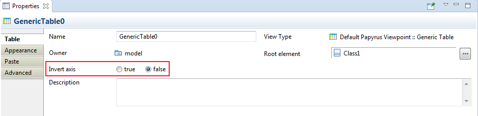

- Invert Axis (Exchange Columns And Rows)
- Select the action Invert Axis in the popup menu or change it into the Table Property View.

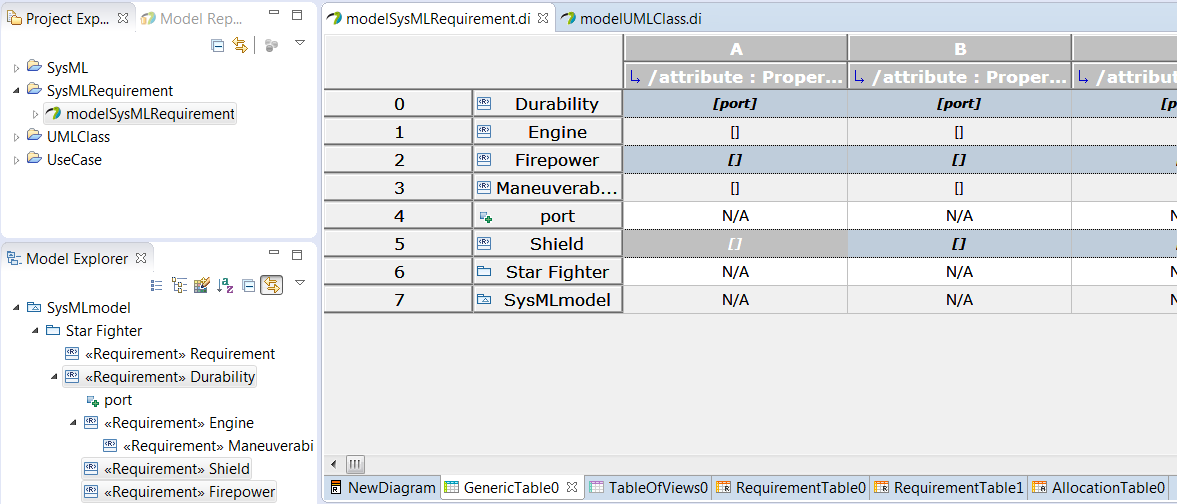

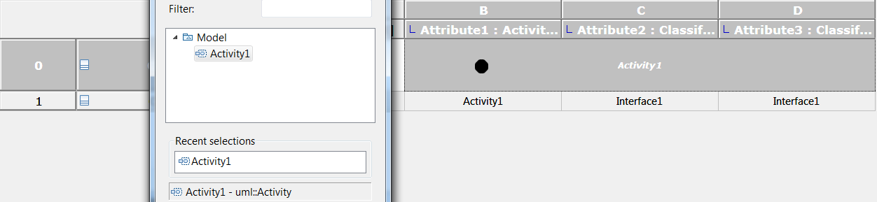

- Add Axis (Column/Row) Element by Drag&Drop from another view (ModelExplorer)
- Select your element and drop it into the table, in the column region or in the row region to add it.

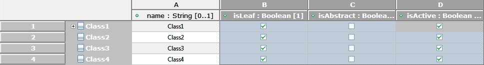

- Sort rows clicking on column header
- Row axis can be sorted by clicking on column header.
- Press ALT
- , then left click on the wanted column header : the rows are sorted ascending,
- clicking a second time, the rows are sorted descending
- clickling a third time, the rows return to the default sort
- Pressing SHIFT + ALT allows to sort rows using several columns. The last selected column is the first one used to do the sort

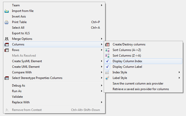

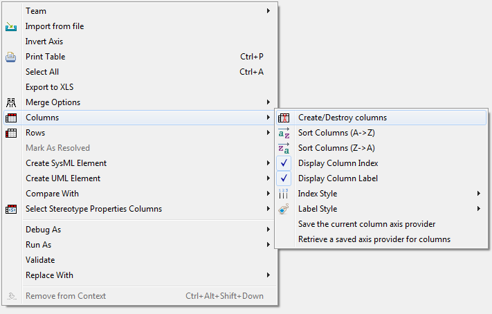

- Choose the Displayed Columns/Rows
- Right click in the table (not in the header) and select Columns -> Create/Destroy Columns. (the same thing for rows

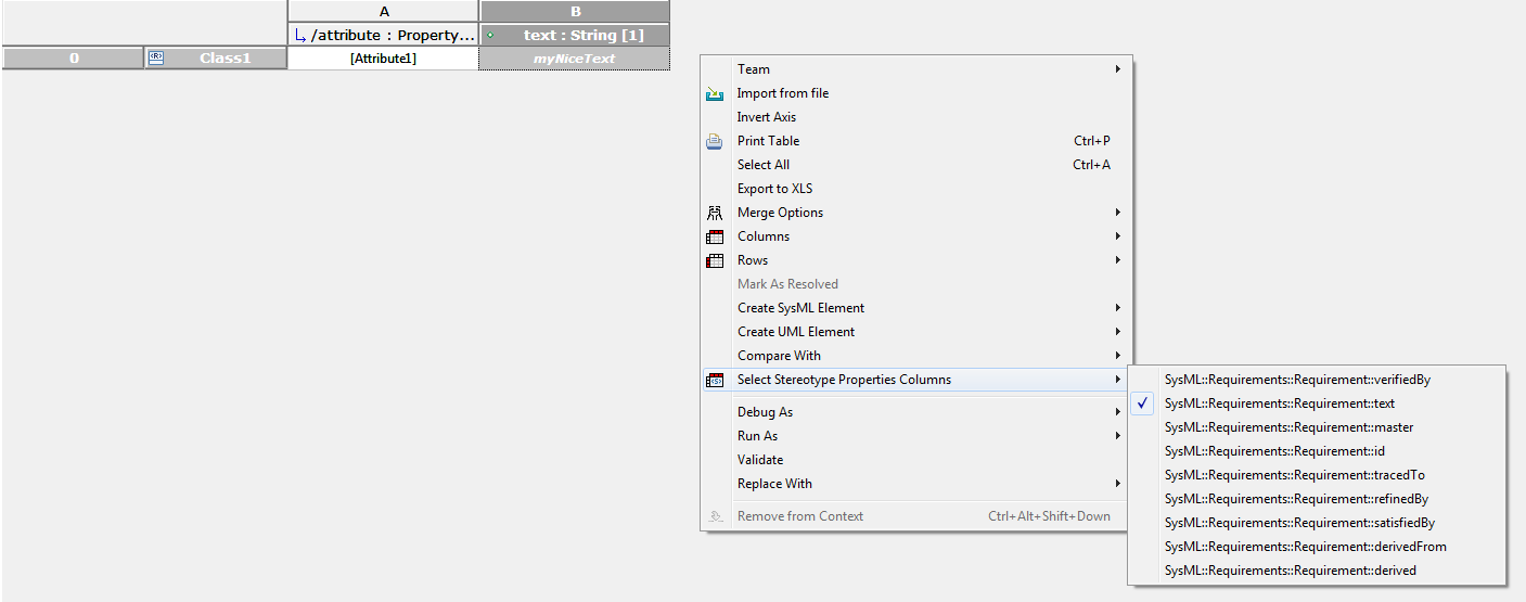

- Choose the Displayed Columns/Rows for Stereotype Property in the popup menu
- Right click in the table (not in the header) and select Select Stereotype Properties Columns (or Rows)

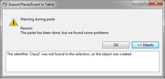

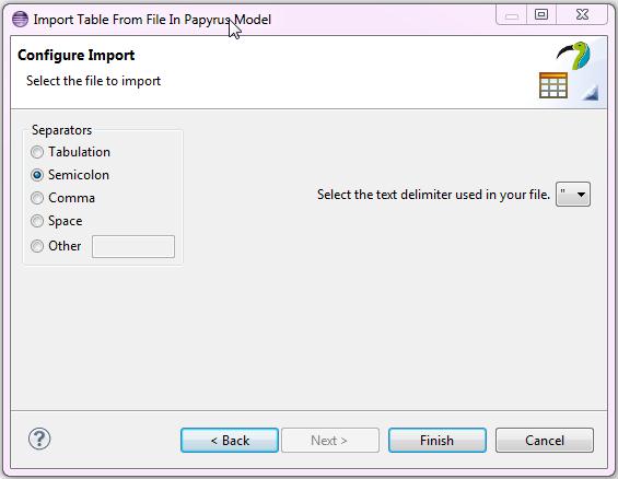

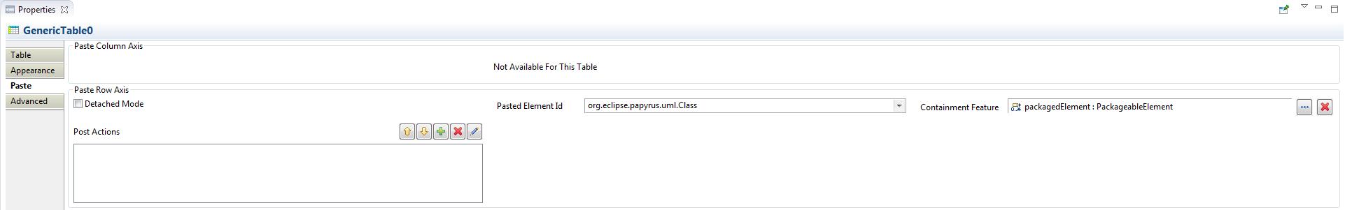

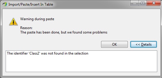

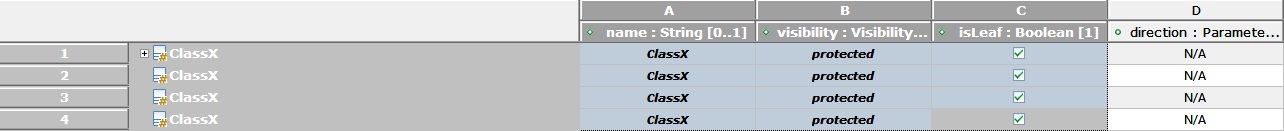

- Paste Columns/Rows From External Spreadsheet
Paste From Spreadsheet in a Table
- Display Index Column/Row Header
- Display Label Column/Row Header
- Configure Index Header Style (A, B, C...Z, AA, AB, ... or 0,1,2,3)
- Configure Label Header Style : select the information to Display in the Header Label (Name, Multiplicity, Type, Icon, isDerived)

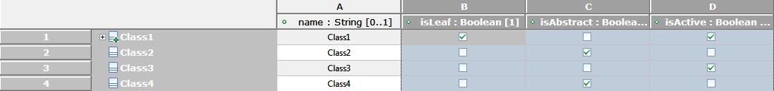

- Select All
- There are 3 ways to do this action
- CTRL+A
- Clicking on the top left corner of the table
- In the popup menu, action Select All

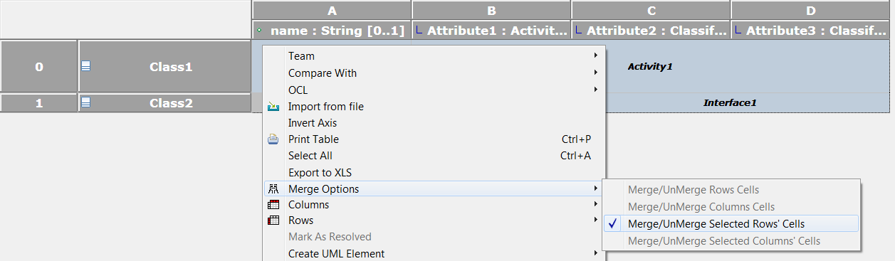

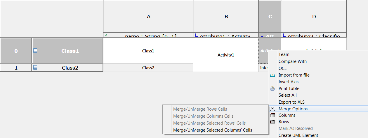

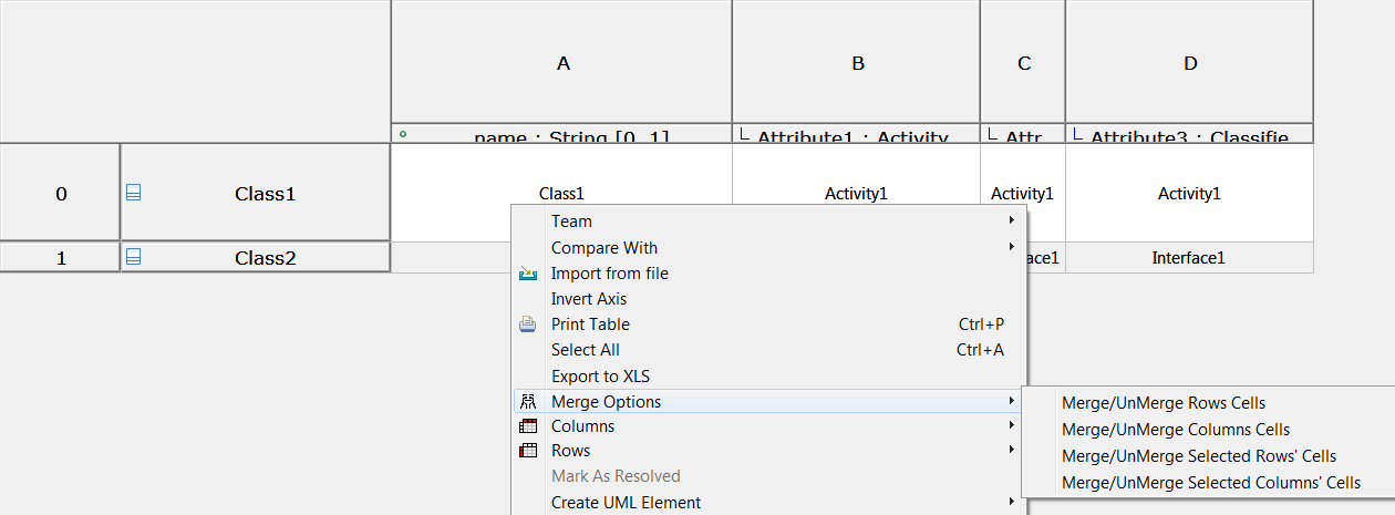

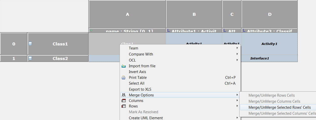

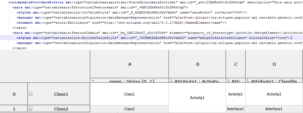

- Merge Cell

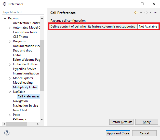

- Configure unsupported cell content
- Go to Windows/Preferences/Papyrus/NatTable/Cell Preferences, then you can define the unsupported cell content.
- Then the content of all cells under unsupported columns will be updated immediately, as showed in the following figure:

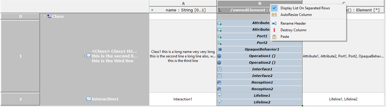

- Display List on Separated Rows for fully selected columns/rows with multiple values
- Select fully a column with multiple values (or a row in an invert table) then right click on the corresponding column header to show the context menu and select Display List On Separated Rows

Choose the Displayed Columns for Stereotype Property in the popup menu |
Yes |

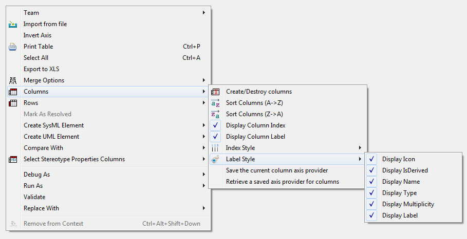

Display Index Column/Row Header |
Yes |
Display Label Column/Row Header |
Yes |
Configure Index Header Style |
Yes |
Configure Label Header Style |
Yes |

Sort Column Axis By Name |
Yes |
Sort Row Axis By Name |
Yes |
No (not yet implemented) |
Save and Restore Several Columns Axis Configuration |
Yes (but, this feature has not really been tested) |
No |

AutoResize Row/Column axis |
Yes (with an action in the popup menu of the header) |
Merge Selected Body Cells
(cells must displayed the same values)
Not supported (and probably will never been supported) |
Merged All Body Cells for a Column
(cells must contains the same values)
Yes (action provided by a popup menu of the body) |
Merged All Body Cells for a Row
Merge Column./Row Header Cells
Merge All Body Cells for Rows AND Columns |
No (not yet supported), you only can merge on rows OR in columns, but not on rows and on columns inside the same table |

Configure unsupported cell content |
Yes (action provided by Preferences/Papyrus/NatTable/Cell Preferences) |
Display List on Separated Rows for a fully selected column of multiple values |
Yes |

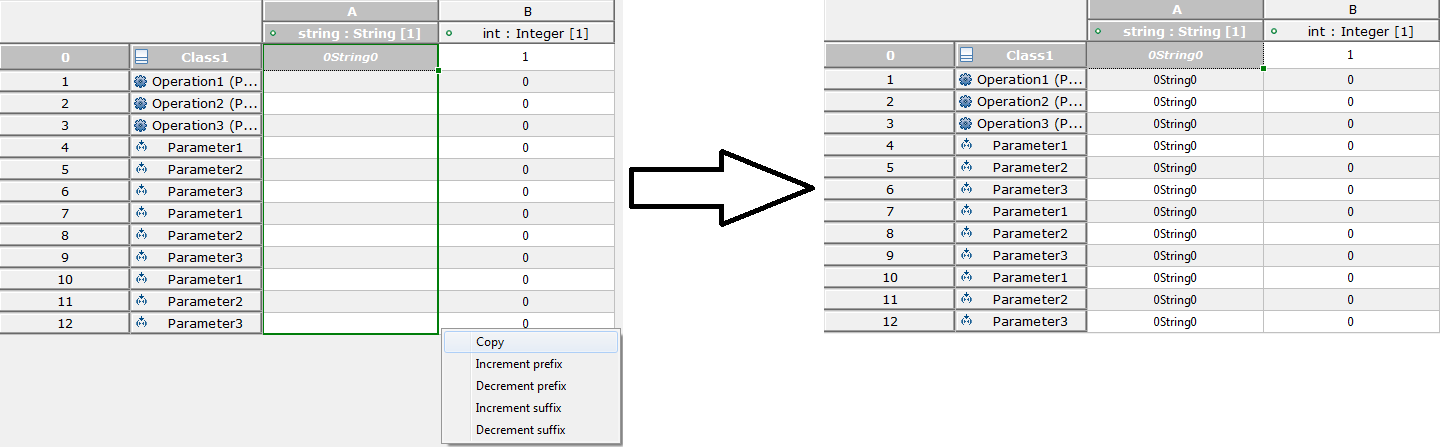

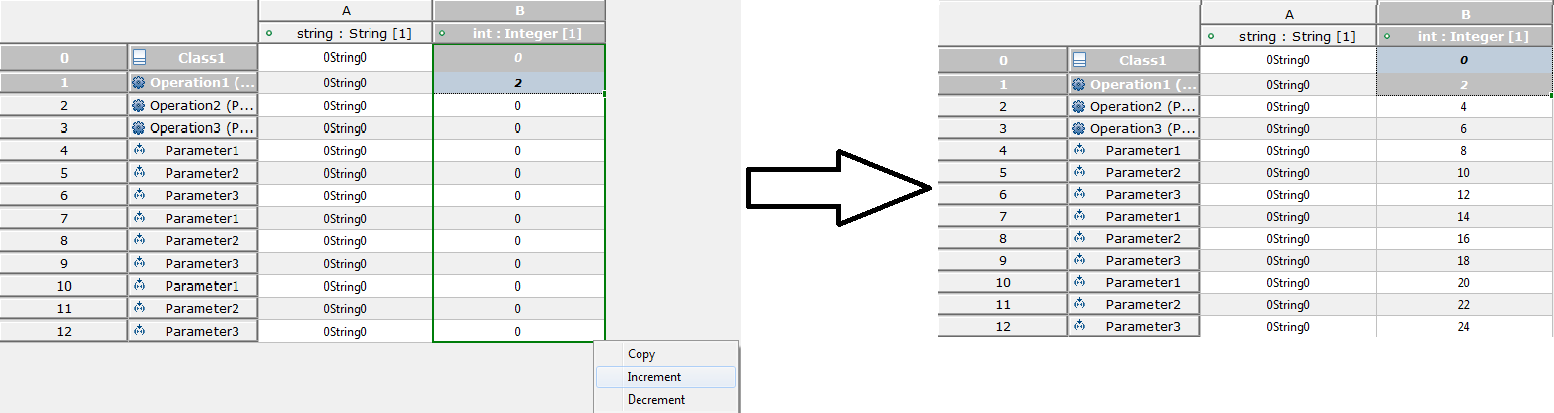

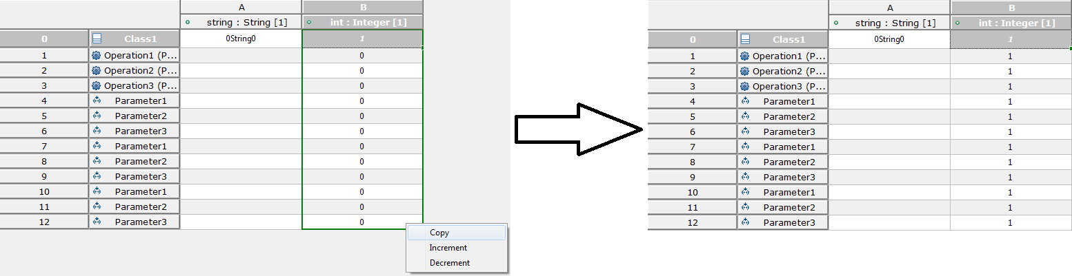

Fill cells
The fill action is available in tables and can be used by clicking on the right bottom corner and drop until release.
This action is available for 2 types:
Fill number values
It is possible to
copy the initial value.
When the initial selection before the fill is a single cell, it is possible to
increment or
decrement values from the initial value by adding or removing 1 to the initial value.
When two cells are selected before filling the selection, it is possible to
increment or
decrement values from the initial value by adding or removing the initial values difference.

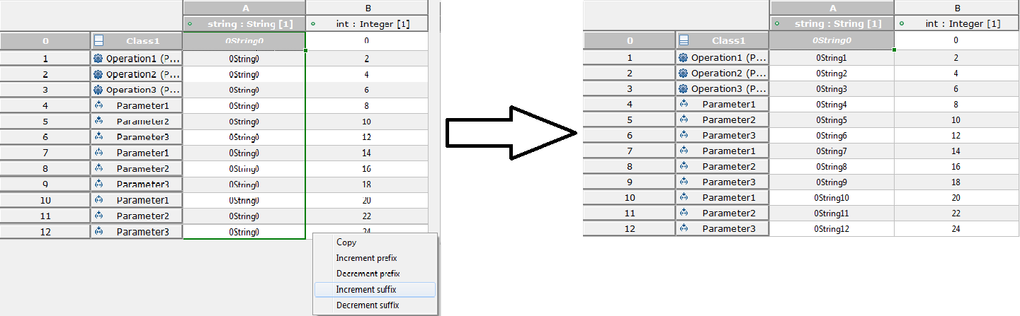

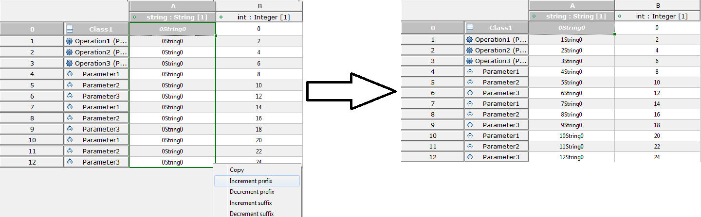

Fill string values
As number fill action, it is possible to
When an integer is available at the beginning or at the ending of the value, it is possible to
increment or
decrement integer
prefix or
suffix values depending of the integer position.
The filled integer values are calculated by the same way than the fill numbers.
Warning: the minus sign is used as minus and not as a separator. So when you have Class-01 and you decide to Increment to name the next one, you get Class00, then Class01. In order to get Class-02 and Class-02, you must use Decrement.

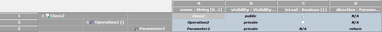

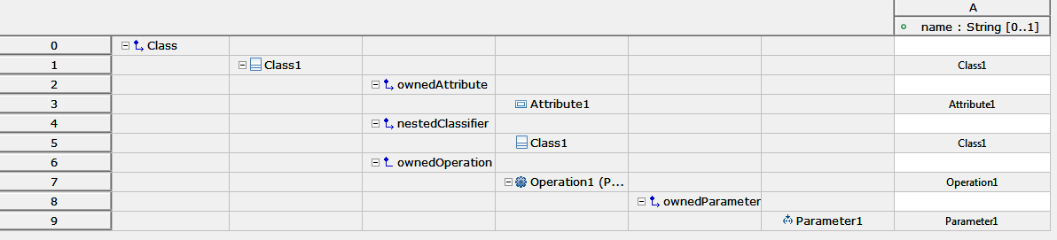

Tree Table Features
The feature of the tree table are mostly the same than for the flat table.
Features not supported by Tree Table
Specific features for the Tree Table
- Expand/Collapse feature : These actions are available in the popup menu of the row header. Several expand/Collapse actions are provided:
- Collapse All : collapse the whole Tree
- Collapse All for selection : collapse all for selected rows
- Expand All : expand the whole Tree
- Expand All For Selection : expand all for selected rows
- Expand Selection on 2 levels : expand the selected rows on 2 levels

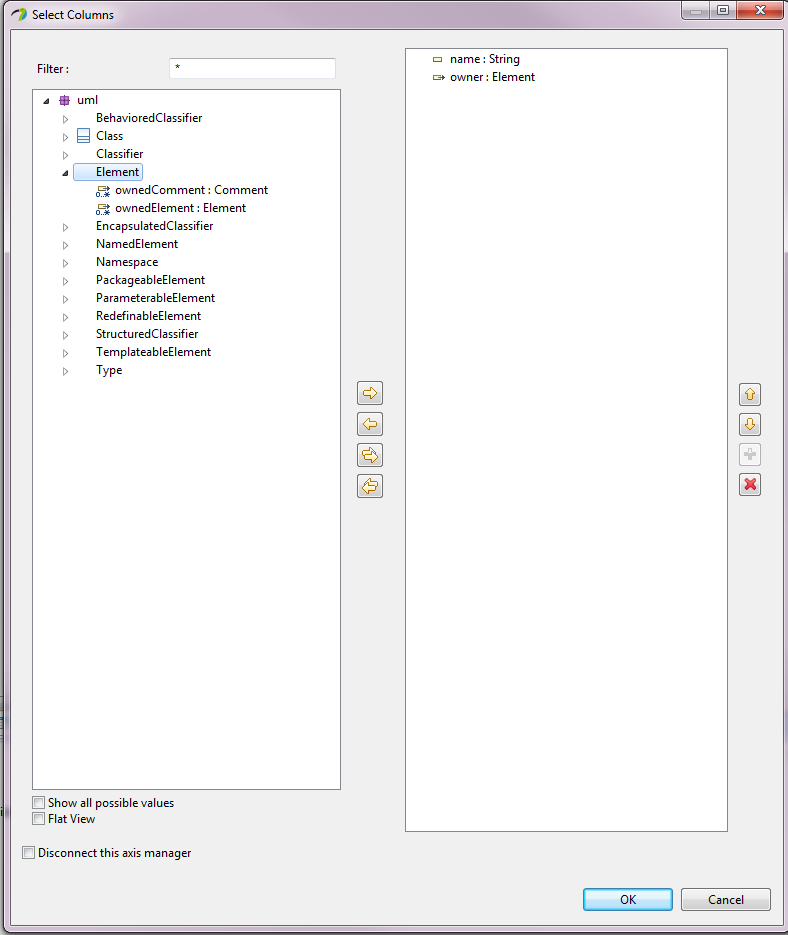

- Choose categories to listen : This action is available in the popup menu of the row header
This action open a Wizard Dialog, when you can choose add/remove depth and edit the categories (features) to listen for each depth.
- 1: Buttons to add/remove categories to/from the right side of the wizard. It work only if a depth is selected, or if the root of the model is selected. In this last case, the categories is added for all depths.
- 2: Checkbox to display all possible values in the left part of the wizard. if it is unchecked, the displayed categories are deduce from the current context of the table.
- 3: Checkbox to choose how to display the categories (flat or tree view)
- 4: move up a selected category for a given depth. It doesn't allow to change the depth of the selected categories
- 5: move down a selected category for a given depth. It doesn't allow to change the depth of the selected categories
- 6: create a new depth (according to the snapshot, the next created depth will be depth 3.
- 7: destroy a selected depth or remove a selected feature
- 8: edit an alias for a category

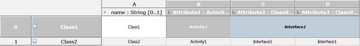

- A: the context of the table
- B: a depth, here depth 0. Categories are not mandatory for depth 0. Categories are mandatory for others depth
- C: the listen categories for depth 1

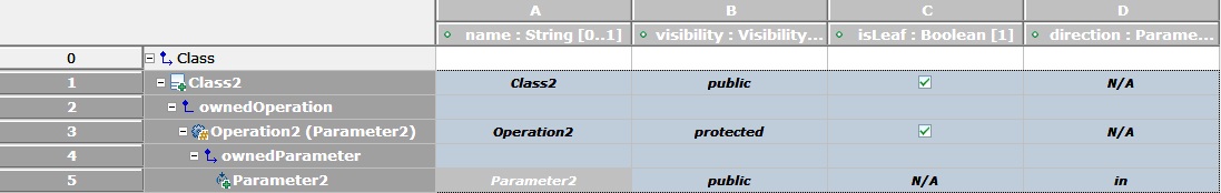

- Show/Hide depth: These actions are available in the popup menu of the row header. you can choose to show/hide categories for a given depth, or hide categories for all the depths

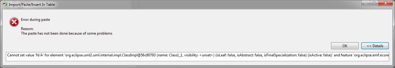

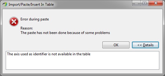

- Name Resolution
- Papyrus table tries to resolve the text pasted from the external spreadsheet. That is to say if the text is pasted in a column representing a boolean, text will be converted in boolean value, if the text is pasted in a column representing a UML NamedElement, we try to find this NamedElement in the exising model to set the value.
- if the resolution of the pasted text failed, we create a CellProblem, to store the pasted value. This value is displayed in the table, underlined in red.

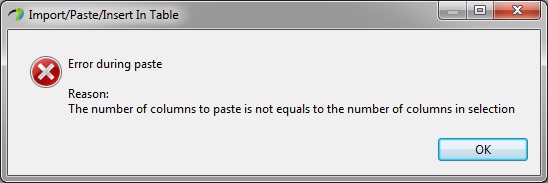

- If the pasted spreadsheet as more columns than the current table, the too many columns will be ignored.
- If the pasted spreadsheet as less columns than the current table there is no problem to do the paste.
- In the mixed case, some rows have too many columns and others not enough, there is no problem to do the paste.

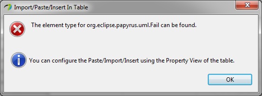

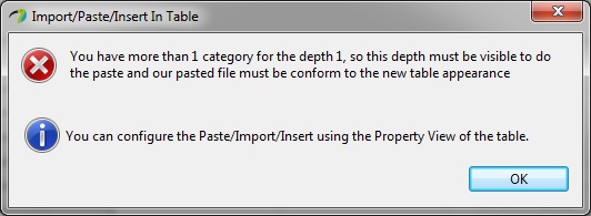

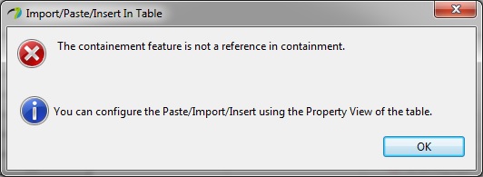

Steps to paste in a Generic Table
We assume that the user wants to paste rows (and not columns).
- Create a new Generic table
- Select the columns to display in your table.
- Select the table in the ModelExplorer View in order to display its Property View

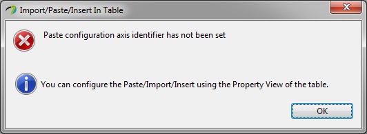

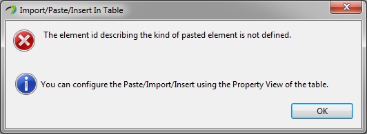

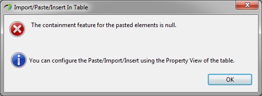

- In the Property View goes into the Paste Tab. 4 informations must be completed by the user:
- Detached Mode (when
true
), paste is faster but actions done by service edit will be ignored.
- if
false
, Paste action uses the service edit (initialize default values, apply stereotypes required by element id).
- if
true
, stereotype required by the element id will be ignored.
- Pasted Element Id : defines the pasted element: org.eclipse.papyrus.uml.Class will create a UML Class
- org.eclipse.papyrus.sysml.Requirement will create a uml.Class stereotyped Requirement, called Requirement0 if Detached mode=false.
- org.eclipse.papyrus.sysml.Requirement will create a uml.Class the name will be initialized only if the user pastes a name value and the steroetype will be applied only if a column requires it or if it is defined by opst actions)
- ContainementFeature : the feature owning the pasted elements
- Post Actions : a way to define 2 kinds of actions:
- actions done just after the element creation, using the paste action
- actions done after have pasting all cell values
- currently, Papyrus provides Post Action only for stereotype application
- currently, Post Actions are ignored when detached mode=
false
Import From Spreadsheet in a Table (CSV File)
The mecanism used for import in the same than for the Paste, so previous rules are always available.
In the popup menu of the table, you will find a menu called "Import From File". This menu allows to import a CSV file, managing the columns separators and the text delimiter.

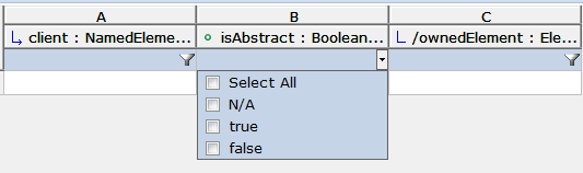

Filter
Since Eclipse Mars, Papyrus Table provides a Filter Row in the Column Header. This row can be shown or hidden.
Filter Feature
- the filter row can be shown or hidden by the user
- the contains of the filter cells is saved in the model, and the user can do Undo/Redo after a filter action
- the filter action is a "one shot", so modifying cells values doesn't reapply the filter
- for tree table
- element which don't match the filter, but which have matching children are shown
- only node already expanded are found by the filter
How to Show/Hide Filter Row
To Show/Hide the filter row, do a right click in the body of the table, then choose Select the Column Menu, then Display Row Filter.
Now, the filter row is visible.
Filter Strategy
- By default, the row with a cell contains is inconsistent with the column are hidden. There is 2 main cases in Papyrus:
- the cell display N/A for a value which is not a string
- the user uses
num:
(see below) in the string editor, all values which are not numerical values will be hidden
- In case of filtering on several column in the same time, we will display only the rows matching all applied filters
- In case of collection in a cell, the row matches if the collection contains the wanted element
Available Cell Editors for Filter Row
By default, Papyrus provides 2 kinds of editors for filters:
- a combo with checkboxes allowing multi selection, that we use for
- a string editor used to filter all others kinds of values.
- string
- references
- numeric (integer, real, ...)

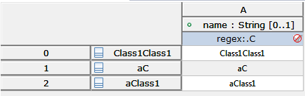

regex:
: This mode allow you to type a regex. The result will be all rows where we found a substring matching the regex
regex_m:
: This mode allow you to type a regex. The result will be all rows where the regex match the full label
start:
: This mode allow you to find all rows where the label displayed for the filter column start by your string
Regex
Starting with this initial state:
regex:.C
will give you this result: all strings owning a C in upper case, preceded by one other character have been found
and regex_m:.C
will give you this result: all string owning only 2 characters, where the second one in a C in upper case have been found

Synchronization between tables and model explorer
Generalities

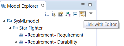

As illustrated below this feature is enabled when the <I>Link With Editor</I> button is activated :
This link the active diagram, in the multi editor view, with the model explorer view. This link works bidirectionally.
As shown below, more than one element can be selected in one view and their counterparts, if present in the other, will be automatically selected as well.
<I>It is to be noted that, when changing pages, the selection for each of them remain in memory and handled by setInput in tabbedPropertySheetPage</I>

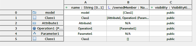

Row selections

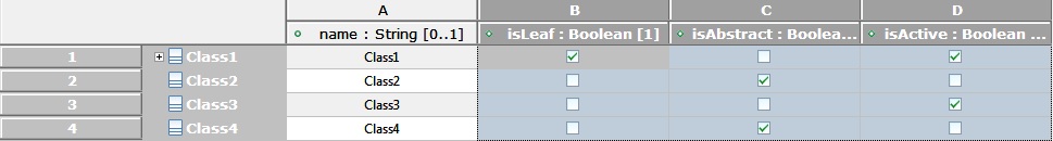

The default behavior of the tables, and their representation, is to list the appropriate elements as rows with each property indicated by a column as illustrated below.
Column selections
The axis of the table can also be inverted and the elements represented as columns with their properties as rows :
Both those selections are achieved either by clicking on the element in the model explorer or the element's row or Column tag in the table.
Cell selections
Wether the axis of the table is inverted or not, the user can select elements represented as cells inside a row or column of the table and see its counterpart selected as well.
It is important to remember that the cell selection is a one way behavior, from cell to model explorer, as the table cannot know what the user wants to select, row or cell, based on a selection in the model explorer.<br/ >
Mixed Selections
A behavior worthy of notice is that elements represented as cells, for example elements owned, if selected in conjunction with a row or a column, in the event of an inverted axis, produces a mixed selection of all the elements in the model explorer.
From the model explorer
As a reminder, selections initiated by the model explorer will only result in column or row selections as the table has no means of knowing what type of selection is required by the user.

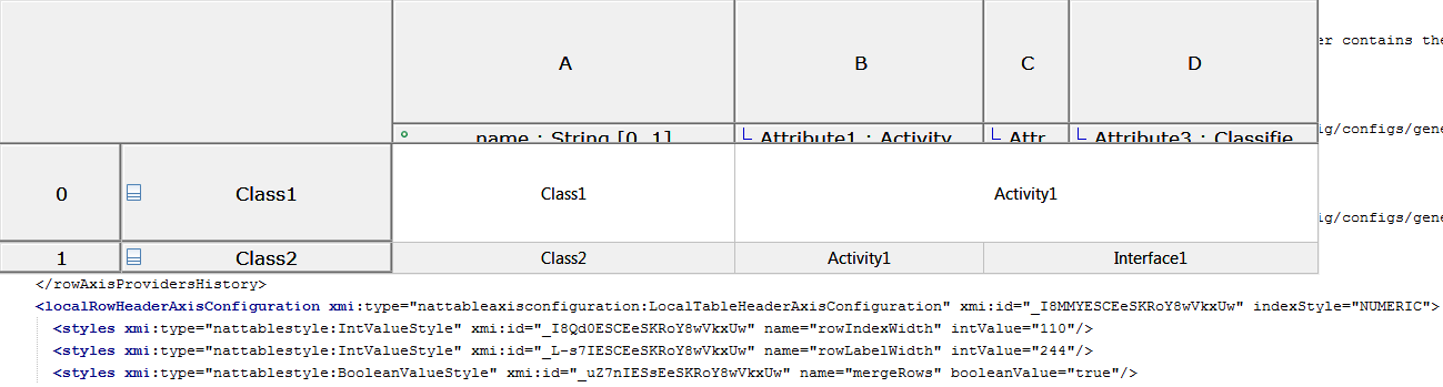

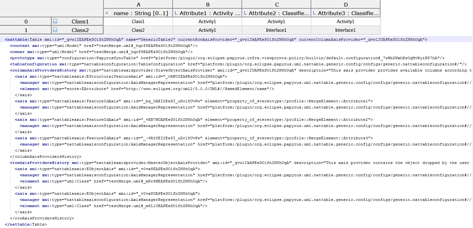

Styles in the resize of a table's components
NamedStyles are used to introduce those changes and intValues ares used to mark the resizing of table elements.
Below is the default model used for the table used to demonstrate the changes when styles are written and/or applied in a table.
Sliding the header's cell frontier will result in the creation of a <I> localHeaderAxisConfiguration </I> and to it will be add the new values of the header's width and/or height. Both sets of headers can have stored values for heoght and width as the table can be inverted and if so the row and the column headers will be too.

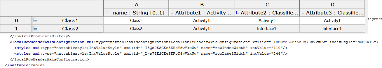

Below is the state of the model during the first change: resizing the row headers' index and label.
In this case the local header created is the RowHeader but if the column headers are changed the model gets a ColumnHeader as illustrated by the image below.
Resize of the Axis
The values carried by the localHeaders only affect the headerLayer of the table and therefore the height or width of the Axis (columns and/or rows) will not be affected by them. For those to change, new values will be carried by the Axis themselves as can be seen in the following image. Of course, the method used to change the values is the same sliding of the frontier used when resizing the headers.
In this example one row and two columns were changed and they all bear the corresponding value in their Axis element.

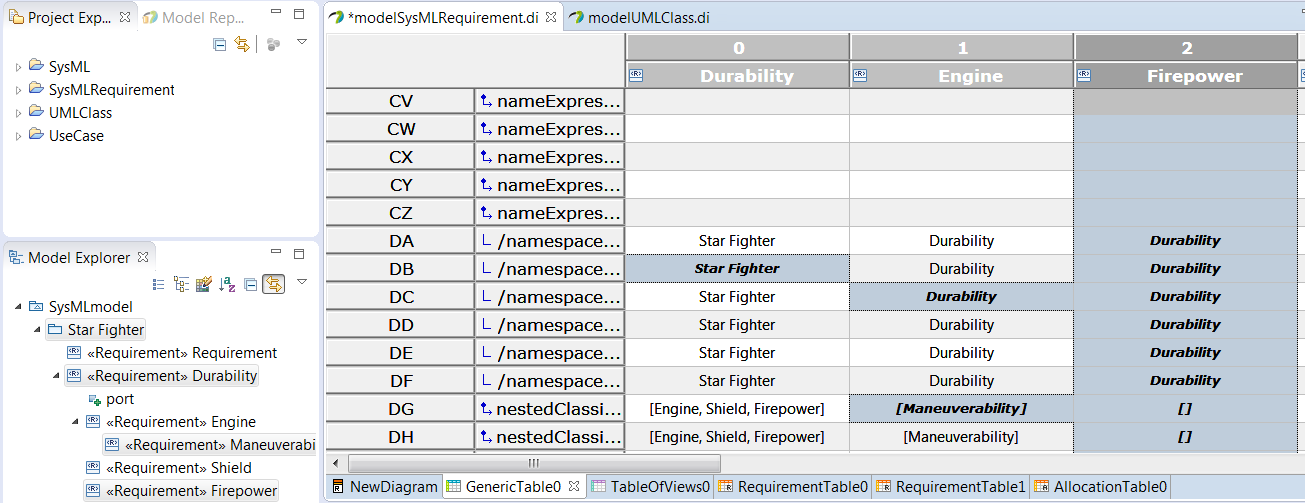

Styles in the merge of Axis elements
For this type of change the NamedStyles used are booleanValues, indicating if the Axis are to be merged or not.
The behavior has been copied from the previous one and the booleans will be caried by the Axis, in case of a user selecting the axis to be merged, or the localHeaders if the user chooses to merge all the rows or columns of the table in one go.

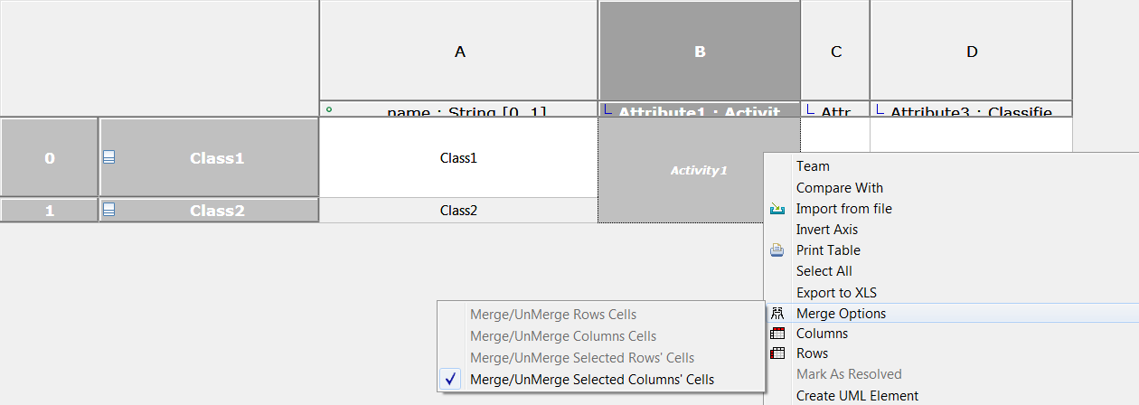

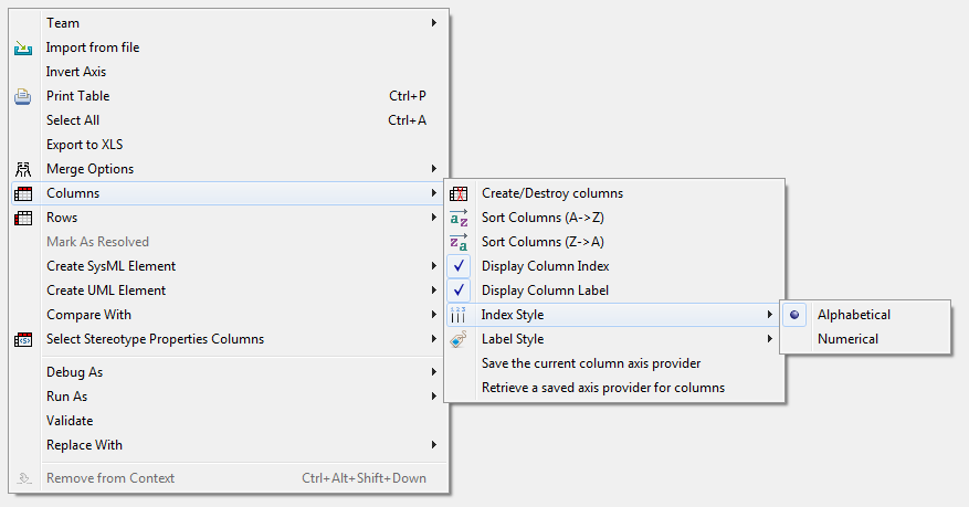

To initiate the merge, the user has access to a merge menu and chooses between the four types of merge the one best suited to the task (as illustrated below). The programm then proceeds to merge the cells of same value inside the selection.
Merge selected Axis
As mentionned above, in case of a merge of a selected axis, the boolean will be caried by the Axis element in the model.
The other choices will then be greyed-out and a toggle will be displayed on the selected option to notify the user that this is (or these are) the axis merge.
If the user selects a cell or an axis that has not been part of the previously merged selection, the toggle will not be displayed but the option will still be visible as the other will still be greyed-out.
It is important to note that, if the user so chooses, the merge option can be reapplied to the new selection and the merge span will consist of the newly selected axis. A cautionary note however as only full rows or columns will be merged.

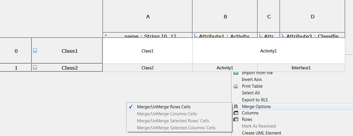

Merge All row/column Axis
The user can merge all the rows in the table and the result will look like this.
Edition of merged Cells

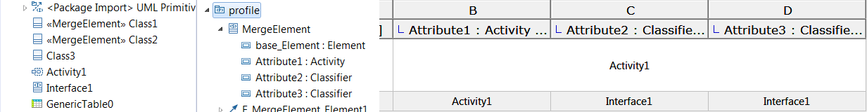

Once the cells are merged, the user might want to edit them. This edition can be problematic as the merge only takes into account the values of the cells and not their types when applying the merge option. This is shown in the example below asa classifier can be an activity but not the other way around.
The first image illustrates the model and the profile's stereotype, applied on both classes, containing the three attributes activity and classifiers.
When the user clicks on the left most part of the merged area, under the activity label, the editing tool only shows activity1 as a possible choice. But if the user selects the right side, under the classifier label, then the choices are many. In this example the choice is to apply the interface type to the merged cells and handle the editing behavior as illustrated by the three next images.
The tool will then automatically detect the possibility, or impossibility, of the edition and split the merge accordingly.
Please note that the merge selection will not be changed and the selected axis will still carry their merge booleans as other values might still be equal and therefore the user might still want those merged.

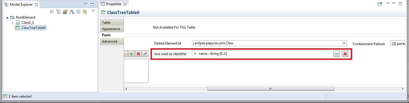

How axis identifier comparison works
In some cases (A1, A2 and C2), the existence of the pasted or inserted objects must be checked. This is done by comparison between pasted object axis identifier and the existing axis identifier values.
To define this axis identifier, just select the column (available in the table) from the paste configuration:

Here, you will find the possible warning messages at the end of the paste/insert (if no modification is applied during the paste/insert and a warning message was caught, the warning message must be displayed as error):
- When an identifier is not found in the selection:
- When an identifier is not found in the selection but is created:

- PasteConfiguration definition error
- Error during the process of the paste/insert
PasteConfiguration errors
Here, you will find the possible paste configuration error messages at the end of the paste/insert:
- When the element id is not defined:
- When the containment feature is not defined:
- When the axis identifier is not defined (and when it is necessary):
- When the element type cannot be found:
- When the feature is not containment:
- When the feature is not compatible:
- When the context of the table does not have the declared containment feature:
- When a TreeFillingConfiguration does not have paste configuration:
- When more than 1 category is defined for a depth and when the table has hidden categories:
Errors during the process
Here, you will find the possible error messages at the end of the paste/insert:
- When the axis identifier was not found in the table:
- When the number of rows pasted is not equals to the number of rows in the table:
- When the number of columns pasted is not equals to the number of columns in the table:
- When the 'Replace' action is wanted by the user but more than one object correspond to the identifier:

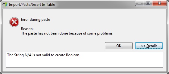

- When an invalid value tried to be set in a new object in attached mode or during the update:
- When an invalid value tried to be set in a new object in detached mode:
- When an unknown exception occured:

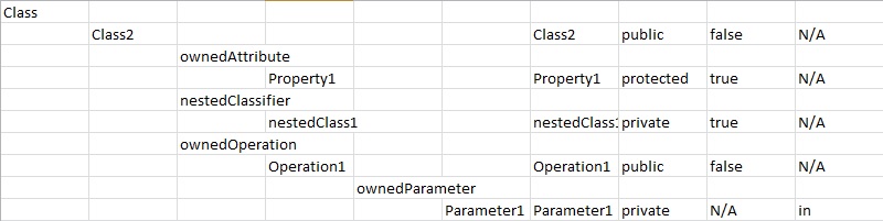

The paste with rows header in the clipboard must respect the number of columns in the target table.
The hierarchy of the rows header must be respected, i.e. when the categories are hidden or shown.
When the categories are hidden, the number of defined categories by depth must be equals to 1 if you want to paste.
N.B: The undo/redo is not implemented for this paste.
Examples
Visible categories
Get the following current table:
And this copied text:
The objects are created with the correct values:
Hidden categories
With this following categories configuration:

For the TreeTable, some specifications exist:
- if no object was found for the identifier, the created object must be a depth 0 object because we can't defined the depth of the paste object
- if an existing object is found for the identifier and the user wants its creation, an object with the same depth will be created depending on the paste configuration of the existing object
- the non first level created object won't be at the end of the table but at the end of the feature which it is associated
Example

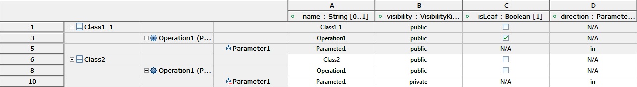

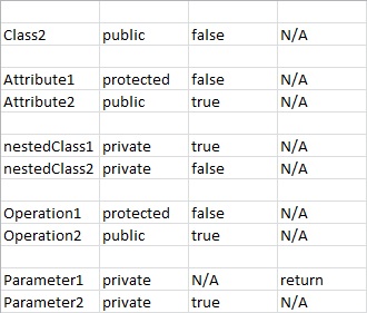

Depending on the previous specifications explained, the result is the following:
Paste with cells selection (B1)
Depending on the selection and to the clipboard, differents actions are possible:
- if only one cell is selected, the cells corresponding to rectangular width and height of clipboard must be overwritten
- if some rows are selected and only one is available in the clipboard, the selected rows must be updated with the values of the single row of the clipboard
- else the width and height of the selection must be equals respectively to the width and height from the clipboard, the selected cells will be modified
Examples

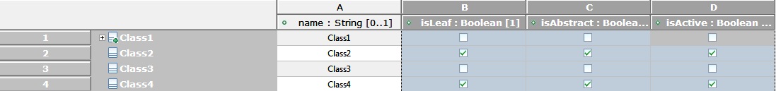

Cells with some rows and columns
Get the following current table and selection:
The result of the paste is selected and is this following:
One cell selected

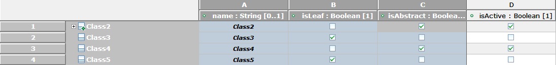

This paste allows to update the selected existing rows when the rows header height selected is equals to the height of rows in the clipboard.
Example
The result of the paste is selected and is like following (the first class is not modified because it does not exist):

Import from file (CSV)
The import from file (CSV) works like
paste with rows header when the rows header are available in the CSV.
If the rows header are not available, the rows works like
insert without selection or
insert with rows header selection depending to the selection.
