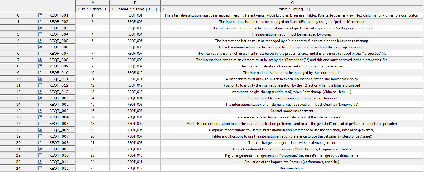

Requirements for the internationalization are this following:

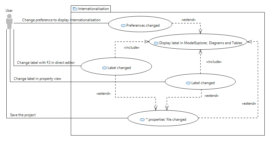

The principal use case for this feature is this following:

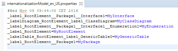

Each element which have a label must be written in the properties file as following:

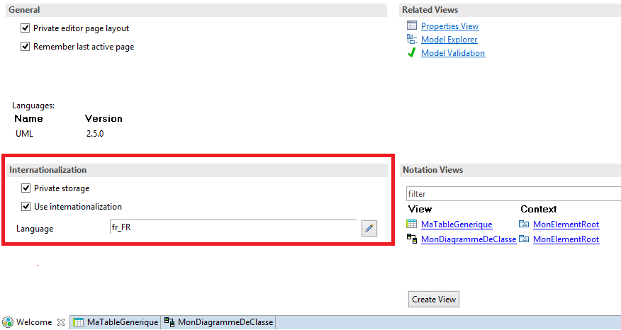

Two preferences are managed in the Papyrus model:
The preferences are stored as EAnnotation:
Those preferences are managed in a PreferenceStore
in the activator of org.eclipse.papyrus.infra.internationalization.common plugin.

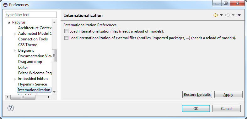

Two preferences are managed for the internationalization activation:
Thoses preferences are stored in the PreferenceStore
in the activator of org.eclipse.papyrus.infra.internationalization.common plugin and are managed by the org.eclipse.papyrus.infra.internationalization.common plugin.
