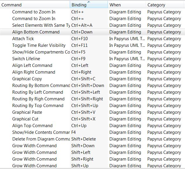

You may find them in Preferences > Keys

There is no easy way to list them (java hard coded)
This table contains some of the mouse bindings:
