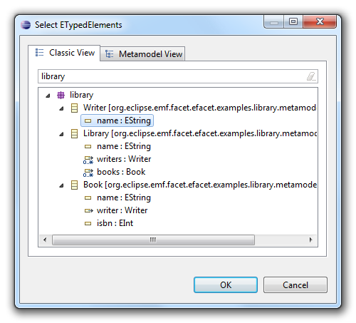

EMF Facet provides an ETypedElement selection dialog:
To open this dialog to let the user select ETypedElements, use IETypedElementSelectionDialogFactory#openETypedElementSelectionDialog from the plug-in org.eclipse.papyrus.emf.facet.efacet.ui. For example:

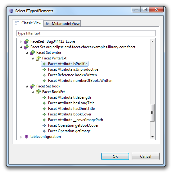

Hierarchical FacetSets
This screenshot shows how hierarchical FacetSets are represented: the org.eclipse.papyrus.emf.facet.efacet.examples.library.core.facet FacetSet contains two FacetSets: writer and book:
This dialog uses the method org.eclipse.papyrus.emf.facet.efacet.metamodel.v0_2_0.efacet.FacetSet.getFacetSets() to get the "subFacetSets". This method can be overridden to tune the behavior of the facet set containment. The aggregate's implementation is based on the override of FacetSet.getFacetSets().

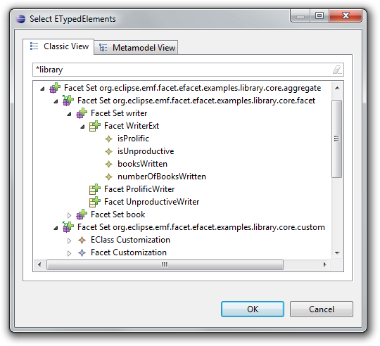

Aggregates
This screenshot shows how aggregates are represented in this dialog: the org.eclipse.papyrus.emf.facet.efacet.examples.library.core.aggregate FacetSet is an Aggregate that aggregates org.eclipse.papyrus.emf.facet.efacet.examples.library.core.facet and org.eclipse.papyrus.emf.facet.efacet.examples.library.core.custom:

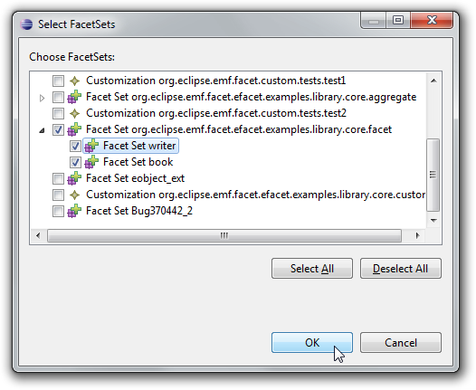

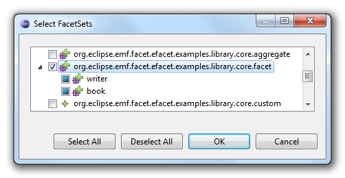

EMF Facet provides a FacetSet selection dialog:
To open this dialog to let the user select FacetSets, use IFacetSetSelectionDialogFactoryopenFacetSetSelectionDialog from the plug-in org.eclipse.papyrus.emf.facet.efacet.ui. For example:
