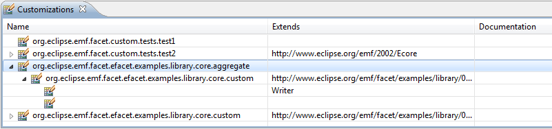

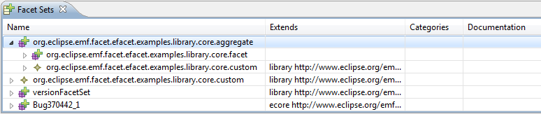

Views
The Aggregates are displayed in the Customizations and Facet Sets catalog views. You can use these views to check that your Aggregate was correctly registered :
