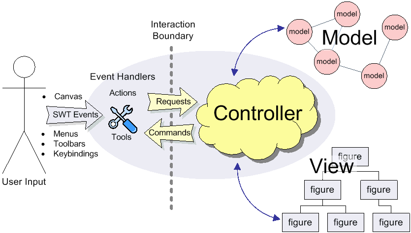

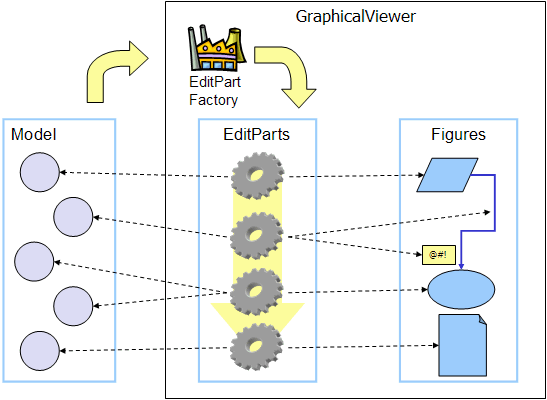

The diagram below shows a high-level view of GEF.  GEF can be loosely defined as the region in the middle. The framework provides the link between an application’s model and view. It also provides input handlers, such as tools and actions, that turn events into requests. Requests and Commands are used to encapsulate interactions and their effects on the model.
In MVC (model-view-controller) design, the controller is often the only connection between the view and the model. The controller is responsible for maintaining the view, and for interpreting UI events and turning them into operations on the model. These roles as they apply to GEF are described below:
Model
The model is any data that gets persisted. Any model can be used with GEF. The model must have some sort of notification mechanism. Although not technically the model, commands are closely related. A command is how the model is modified in a way that can be undone and redone by the user. In general, commands should work only on the model itself.
View (Figures/TreeItems)
The view is anything visible to the user. Both Figures and TreeItems can be used as view elements.
Controller (EditPart)
There is usually one controller per visualized model object. The controller is called an EditPart. Editparts are the link between the model and the view. They are also responsible for editing. Editparts contain helpers called EditPolicies, which handle the much of the editing task.
Viewers
An EditPartViewer is where editparts display their view. There are two types of viewers provided in GEF. A graphical viewer hosts figures while a tree viewer displays native treeitems. GEF viewers are similar to JFace viewers in that they manage an SWT Control. Viewers are also a selection provider, and the unit of selection is the EditPart.

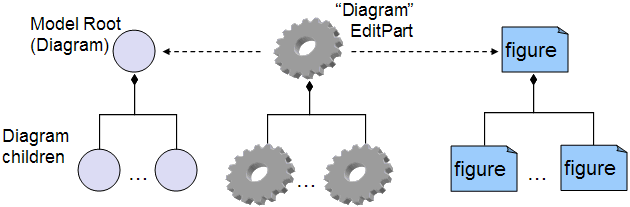

An Introduction to EditParts
Editparts associate their view and model, but they also form their own structure. An editpart maintains children. Usually this corresponds to a similar containment found in the model. For example, the model may consist of a diagram containing nodes. There would then be a corresponding diagram editpart which contains multiple node editpart children.
The parent-child relationship of editparts carries over into their figures. The parent’s figure will contain the children’s figures. Or, in some cases the parent part’s view is a compound view composed of several figures, one of which is designated as the content pane. The figure of each child is added to the content pane. The end result is that you have three separate hierarchical data structures which are approximately parallel to each other.
Connections are the exception to this simple tree structure. Connections represent a link or association between two objects. A Draw2d connection figure is used as the view. Connections may be stored in any way in the model, but the editparts are managed by the source and target editpart at each end. A connection editpart’s figure containment is also handled specially. The connection figure is added to a special layer in the diagram so that it paints above the primary layer containing non-connection parts.
There are two types of editpart implementations provided with GEF. Graphical editparts use figures as their view. Graphical editparts also add the ability to support connections, which themselves are graphical editparts. The other type is a tree editpart. Tree editparts use SWT treeitems as their view.

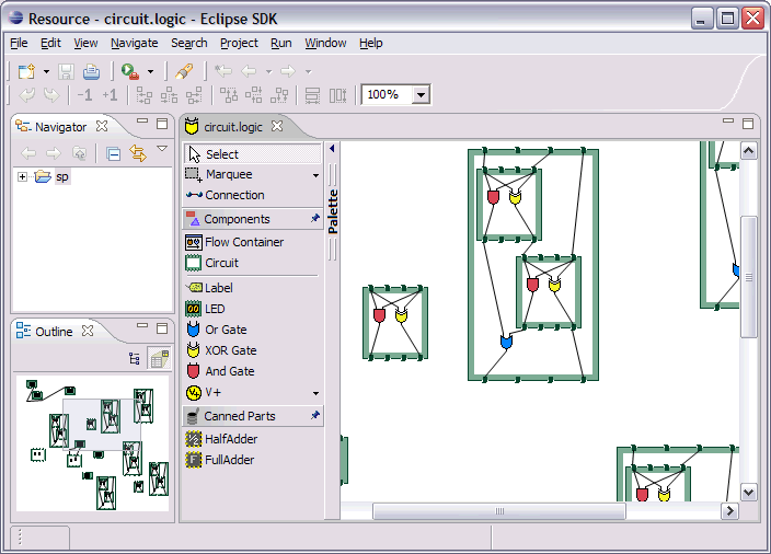

GEF’s PaletteViewer provides an SWT Control allowing the user to select which Tool is active. It can also be a drag source for dragging objects from the palette directly into the diagram. Use of the palette is optional, but common.
The palette can be placed anywhere, including inside the editor. GEF provides a Workbench View for hosting the Palette. Also, a custom Composite, the FlyoutPaletteComposite, will manage the placement of the PaletteViewer beside a primary Control. This composite is used as the editor’s primary control in the Logic Example, shown below:
The PaletteViewer displays a Palette model, which starts with the PaletteRoot. The root organizes the contents using either drawers, which open and close, or groups, which do not. Each grouping element then contains Palette Entries. An Entry defines either a tool or template for the User. Templates are described below in Creation.
The Palette provides several display modes, such as icon-only. You can also provide a customizer to allow the user to modify or create palette content.

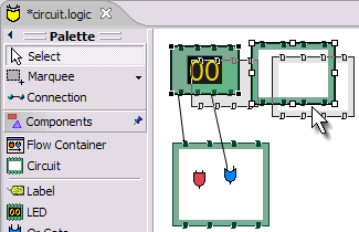

No interaction is more basic or universal than selecting items in a viewer. Most of the interactions discussed here operate on what is currently selected. Yet, selection is a complex topic and there are several steps involved. The Selection Tool was briefly discussed in the above section on tools.
Let’s first define selection. Selection is a List of EditParts maintained by an EditPartViewer. Changes to the selection are made by invoking methods on the viewer, and not by modifying the list directly. The selection is never empty. If the selection is cleared, the viewer’s contents editpart becomes the selection. The last editpart in the list is considered the primary selection.
Closely related to selection is focus. Focus is a single editpart maintained by the EditPartViewer. Focus is used when manipulating selection via keyboard. By moving focus, the user can navigate from one editpart to another without changing the current selection. The user can add/remove the focused editpart from the selection. If focus is not explicitly set, it is the same as the primary selected part.

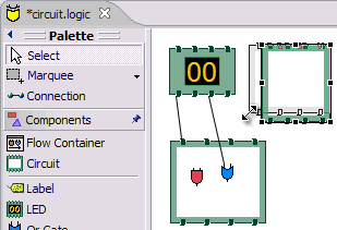

Selection Handles
The editpart is responsible for showing its selected and focused state to the user. The viewer tells editparts when they are selected, focused, or have primary selection. Typically, selection is shown by one or more EditPolicies adding selection handles. The handles shown here on the LED and circuit parts were added by ResizableEditPolicy. The black handles indicate primary selection.
Because selection handles are related to how a part can be dragged or sized, which in turn is related to the containing figure’s layout manager, it is usually the parent part’s editpolicy that installs a policy on the children for displaying the appropriate handles. For example, an XYLayoutEditPolicy would install a ResizableEditPolicy on each child of its host editpart.
Connections may (WireEditPart in the Logic Example) also change its figure’s line width to help indicate selection. Handles for connections are contributed by both EndpointEditPolicy and BendpointEditPolicy.

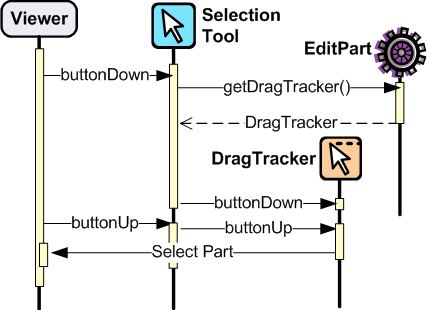

For selection to occur, the Selection Tool must first target an editpart using a SelectionRequest. In rare cases, an editpart is not selectable and targeting "falls through", hitting the editpart below. During this continuous mouse targeting, the Selection Tool invokes showFeedback() on the current target editpart by passing it a SelectionRequest of type REQ_SELECTION. It is recommended that most applications ignore this request since showing and hiding feedback as the mouse moves across a diagram can be very distracting to the user. For this reason, there is an additional feedback request sent with the type REQ_SELECTION_HOVER whenever the user pauses the mouse over an editpart. Often an editpart will display a popup shell similar to a tooltip displaying additional information about the part. The SELECTION_FEEDBACK_ROLE identifier can be used when installing policies which show such feedback.
A benefit to using these feedback requests is that the Selection Tool is smart about asking parts to erase feedback. For example, if the user starts dragging, you would not want a popup message to stay around. Also, selection feedback will not occur when other tools are active.
Selection via a DragTracker
Once the user actually presses down on the mouse, the selection target will be asked for a DragTracker. To allow selection, return a SelectEditPartTracker or its subclass DragEditPartsTracker, depending on whether dragging is permitted. These trackers will modify selection at the appropriate time, taking into consideration the SHIFT and CTRL modifier keys.
The contents editpart should never be selected by a tracker. The reason being that it should never be part of a multiple selection. Therefore, it should return either a DeselectAllTracker, or the MarqueeDragTracker. Remember, the selection is never empty so the contents part will be the selection when all other parts are not selected.

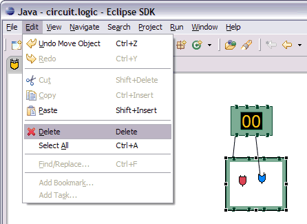

Basic Model Operations (Delete)
Tools Requests Edit Policies and Roles Actions
REQ_DELETE
COMPONENT_ROLE
CONNECTION_ROLE
RootComponentEditPolicy
DeleteAction
The only universal interaction that all GEF applications should support is delete. The workbench places a global delete action on the edit menu. All applications should register a handler such as the included DeleteAction.
The DeleteAction sends a GroupRequest of type REQ_DELETE to the viewer’s current selection. All editparts should have an editpolicy which either supports or prevents delete from occurring.
Every editpart is either a component or a connection. A component is a basic editpart that is the child of a parent. A connection is slightly different because it is owned by its source and target.
The COMPONENT_ROLE key is used when installing an editpolicy on a component editpart. Applications can extend the provided ComponentEditPolicy to fill in the commands for deletion. The RootComponentEditPolicy should be used on the contents editpart. This policy prevents the diagram itself from being deleted. Here, "root" refers to the model root and is not related to the viewer’s root editpart.
The CONNECTION_ROLE key is used when installing a policy on a connection editpart. Applications can extend the provided ConnectionEditPolicy to fill in the command for deletion.
These editpolicies should handle the tasks most closely associated with the model. In the logic example, this role is responsible for the LED’s increment and decrement behavior, which adds or subtracts one from the LED’s value.
Implementing the command that performs delete can be difficult, especially when connections are involved. The command must consider whether the object being deleted has connections, or if children of the object being deleted have connections, and delete the connections as well. But, you don’t want to delete the same connection twice in cases where both source and target nodes are being deleted as part of multiple selection. The logic example’s delete command addresses all of these concerns.

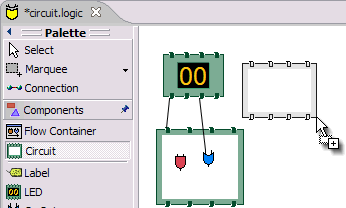

Creation
CreationTool
REQ_CREATE
Create
CONTAINER_ROLE
LAYOUT_ROLE
TREE_CONTAINER_ROLE
ContainerEditPolicy
LayoutEditPolicy
CopyTemplateAction
PasteTemplateAction
TemplateTransferDropTargetListener
TemplateTransferDragSourceListener
A CreateRequest is used to ask an editpart to create a new child. The request is identified by the ID REQ_CREATE. Creation can occur through three different methods: clicking, dragging, or pasting. The request provides the location, object, and object type being created. The object and its type are provided by a CreationFactory. The request hides the factory and provides access to the created object directly, caching it in case multiple editpolicies all need access to the created object. In some cases, the request will contain a size attribute.
Producing CreateRequests
The creation tool provides a "loaded cursor" mode which will attempt to create an object at the mouse location when clicking. If the mouse is pressed and dragged, the tool will track the size of the rectangle defined by the user. The creation tool can be placed on the palette using a CreationToolEntry. When the mouse is released, the tool will either repeat the process or switch back to the default tool.
Creation can also be performed using native Drag-and-Drop. The drag source can be anything, but it is typically the PaletteViewer. A palette entry taking a template is added to the palette. The TemplateTransfer is used to transfer the template, which is just an Object, from the drag source to the drop target. A TemplateTransferDragSourceListener must be added to the PaletteViewer. Similarly, the viewer must have a TemplateTransferDropTargetListener. Since a template is model-specific, the application must extend the drop target listener to convert the template into a CreationFactory for the request.
A special palette entry called the CombinedTemplateCreationEntry supports both the creation tool and drag-and-drop style of creation.
Consuming CreateRequests
The target editpart is responsible for showing feedback and returning the command for creation. GEF provides two types of policies for handling creation. One type of policy is specific for the view in which creation occurs, either graphical or tree-based. This edit policy corresponds to either the LAYOUT_ROLE or the TREE_CONTAINER_ROLE.
The other type of edit policy is specific to only the model, should applications wish to separate out the portion that is shared between graphical and non-graphical creation. In most cases, any kind of shared logic is in the command implementations, making this type of policy unnecessary.
A LayoutEditPolicy handles the process of creation based on the container’s layout manager. For example, if the XYLayout is being used, then the resulting Command will need to associate an (x, y, w ,h) constraint with the created child. Layouts that don’t use constraints would require that the index of the drop location be determined. GEF provides abstract policies for the basic layout types.
The TreeContainerEditPolicy is used for supporting creation in a tree-based viewer. The policy is responsible for determining the index of creation and showing feedback.
The PasteTemplateAction can be used to create objects without the mouse. This is important for accessibility. The CopyTemplateAction is added to the Palette. When the user invokes this action, an internal mechanism copies the transfer so that it can be pasted in a viewer. When paste occurs, the PasteTemplateAction retrieves the template object, constructs a CreateRequest, and sends it to the selected editpart. Mouse location is not available in this interaction. Paste is only enabled when the selection is exactly one editpart.
When a creation command is redone, it must restore the original child that was created the first time it was executed. If it creates a new object, then subsequent commands will fail on redo when they try to modify the originally created child.
Moving and Resizing
ResizeTracker
ChangeBoundsRequest
AlignmentRequest
REQ_MOVE
REQ_ADD
REQ_ORPHAN
REQ_CLONE
REQ_ALIGN
REQ_RESIZE
LayoutEditPolicy
ResizableEditPolicy
ContainerEditPolicy
AlignmentAction
MatchSizeAction
move interaction
resize interaction
The DragEditPartsTracker extends basic selection behavior to allow the selected parts to be dragged within their graphical viewer. Dragging the selected parts can result in three potential interactions: move, reparent, and clone. All three use the ChangeBoundsRequest, which extends GroupRequest to include a size delta, move delta, and mouse location.
While dragging the selection, if the tracker targets the part’s original parent, the request is typed as REQ_MOVE. If the target changes, the interaction becomes a reparent. For a reparent, a request of type REQ_ORPHAN is sent to the old parent, while the new target is sent a request of type REQ_ADD. When the CTRL key is pressed (ALT on the Mac), the operation is always a REQ_CLONE, which is only sent to the target part.
All of these requests are related in that they require the target to process a rectangle and a mouse location. The LayoutEditPolicy is responsible for handling each of these request types. For layouts which use constraints, each part’s original bounds is taken and modified by the size and move deltas to determine a new bounds, for which a corresponding constraint is found. For index-based layouts, the mouse location is used to establish the new index.
A ContainerEditPolicy can optionally be used to contribute additional commands (not related to the layout) during ADD, ORPHAN, and CLONE requests.
Resizing
Resizing falls under the same category as changing bounds. Note that when resizing either the top or left sides, the location of the part is also changed. Resizing only makes sense for layouts with constraints, such as XYLayout. The ResizableEditPolicy adds up to eight resize handles to its host. When the Selection Tool is clicked on one of these resize handles, a ResizeTracker performs a resize on the selected parts understanding "resize". SHIFT and CTRL key modifiers can be used to constrain the resize operation.
The types of handles available on an editpart depend on the layout manager in which its figure is placed. For example, parts inside a table might have handles for adjusting insets, padding, column span, or other attributes. Some layouts don’t need any handles, but four corner handles should be added just to indicate selection. Dragging these handles would be the same as dragging the part itself.
Because of the relationship between handles and layouts, it is recommended that the PRIMARY_DRAG_ROLE editpolicy be installed by the parent’s LayoutEditPolicy, which defines abstract methods for this purpose. If a container changes layout managers during editing, typically the layout policy gets swapped with one for the new layout manager. The new policy then replaces the stale PRIMARY_DRAG_ROLE policies on each child.
The MatchSizeAction matches the size of the selected parts to that of the primary selected part’s size. This action is implemented in a way similar to manually resizing the individual parts, and it uses the same request and type.
The AlignmentAction uses an AlignmentRequest, which extends ChangeBoundsRequest. When using a ChangeBoundsRequest, the part’s current placement in the Control (in absolute coordinates) is passed to the request, which then returns a modified version. Using this pattern, alignment is able to adjust each part’s rectangle by different amounts. In most cases, alignment can be treated no differently than a move. This action aligns all selected parts with one of the edges of the primary selected part.

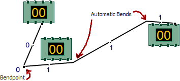

Bending Connections
ConnectionBendpointTracker
BendpointRequest
REQ_MOVE_BENDPOINT
REQ_CREATE_BENDPOINT
BendpointEditPolicy
CONNECTION_BENDPOINTS_ROLE
Certain connection routers accept routing constraints (typically a list of BendPoints). Install a BendpointEditPolicy using the CONNECTION_BENDPOINTS_ROLE for editing the connections routing constraints. This editpolicy requires a router that takes a List of BendPoints. During selection, the policy will add normal handles to existing bendpoints on the connection. It adds smaller handles where the user can create new bendpoints.
Each handle provides a ConnectionBendpointTracker. This tool sends a BendpointRequest back to the connection editpart for showing feedback and obtaining the command to perform the bend. For existing bendpoints, the request is typed as REQ_MOVE_BENDPOINT, otherwise it is REQ_CREATE_BENDPOINT. It is up to the editpolicy to determine when moving a bendpoint back to its natural placement should result in its removal.
This picture shows a selected connection in the Logic Example with a single Bendpoint. The ShortestPathConnectionRouter has inserted additional bends in the connection to avoid figures. The handles for creating and moving bendpoints are labeled with the index that the BendpointRequest will contain. The index is the same as the current (or eventual) index of the bendpoint in the routing constraint’s List.
