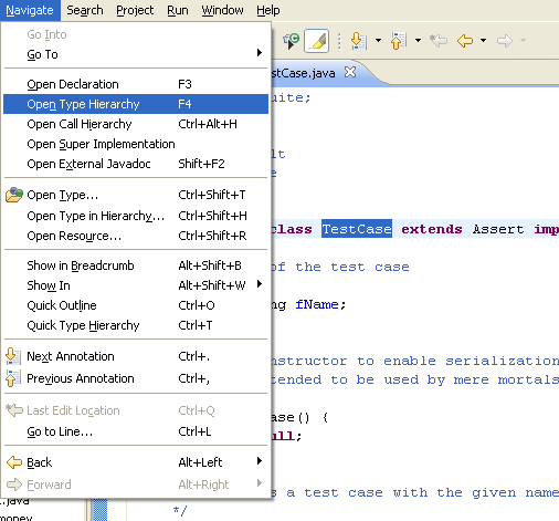

  3. With the TestCase.java editor open and the class declaration selected:
    Menu open type hierarchy

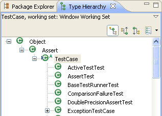

  4. The Type Hierarchy view opens with the TestCase class displayed.
    Type Hierarchy view
    Note: You can also open editors on types and methods in the Type Hierarchy view.
Opening an editor for a selected element
Type Hierarchy View
