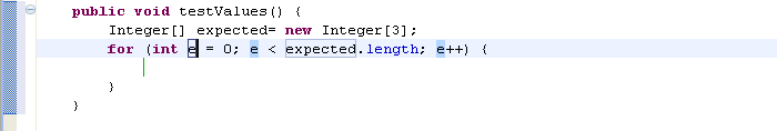

  4. Next we change the name of the index variable from i to e. To do so simply press e, as the index variable is automatically selected. Observe that the name of the index variable changes at all places. When inserting a template all references to the same variable are connected to each other. So changing one changes all the other values as well.
    Altered for template

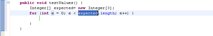

  5. Pressing the tab key moves the cursor to the next variable of the code template. This is the array expected.
    Since we don't want to change the name (it was guessed right by the template) we press tab again, which leaves the template since there aren't any variables left to edit.
