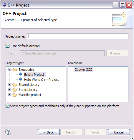

Step 1: You want to create a single project that will reflect all of the components for the existing source tree.
- Select File > New > Project.
- For this tutorial, expand C/C++ and select C++ project.
The New Project wizard displays. Click here to see an illustration (displayed in a separate window). - In the Project name field, type a name for the project.
- Ensure that the Use default location option is not selected because here we will specify where the
resources reside in the file system, in a location other than your workspace.

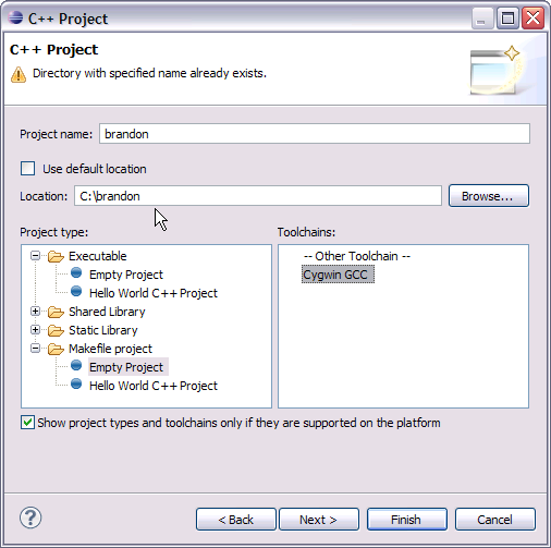

We assume this directory location already exists, and contains e.g. source files and makefile. If it does not exist, it will be created.In this example, we will use an existing
hello.cpp
and its existinghello.mak
makefile, located in the directoryc:\brandon
.Click here to see an illustration (displayed in a separate window).
- In the Location field, specify the path to the existing files for your project.
- From the Project types list, expand Makefile Project and select Empty Project..
- To have sample source and a makefile created in your existing directory, select Hello World C++ Project
- Make sure a toolchain is selected.
- Click Next.

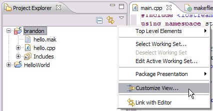

You will see the new project in the Project Explorer view. In addition, new 'dot' files have been created in your legacy project's root directory, these are CDT project files.
- (Optional) To see these "hidden" files, open the view menu on the Project explorer view, and select
"Customize View."
The view menu is activated via the small downward-pointing triangle in the upper right of the toolbar of the view.Click here to see an illustration (displayed in a separate window).

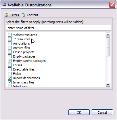

- In the Available Customizations window, on the Filters tab, uncheck ".* resources."
- The formerly hidden 'dot' files are now shown in the Project Explorer.
- Hit OK to close the dialog.

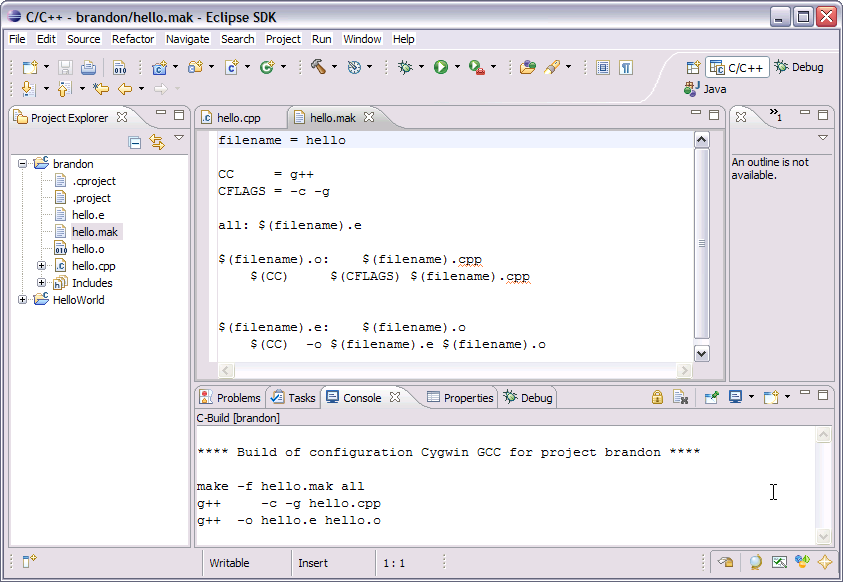

Step 2: You are now ready to build your project.
- To build your project, select Project > Build Project.
You can also hit the hammer iconon the toolbar to build the selected project.
- You may see an error e.g.
"make: *** no rule to make target 'all'.
This is because, in our case, we didn't tell it where the makefile is, or its name.

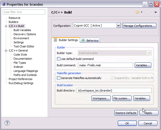

- Open the project properties (right mouse on project name in the Project Explorer view and select Properties at the bottom on the context menu).
- On the C/C++ Build Page, on its Builder Settings tab, uncheck
Use default build command
and change themake
command tomake -f hello.mak
since our makefile is not named the defaultmakefile
- Click OK to close the Project Properties window.
- Your project will probably rebuild. If not you can force a build via
or use the hammer icon
After the project build completes, the results display in the Console view and new objects, such as binaries and includes, show in the Project Explorer view.
- Review the results to ensure that there are no errors.

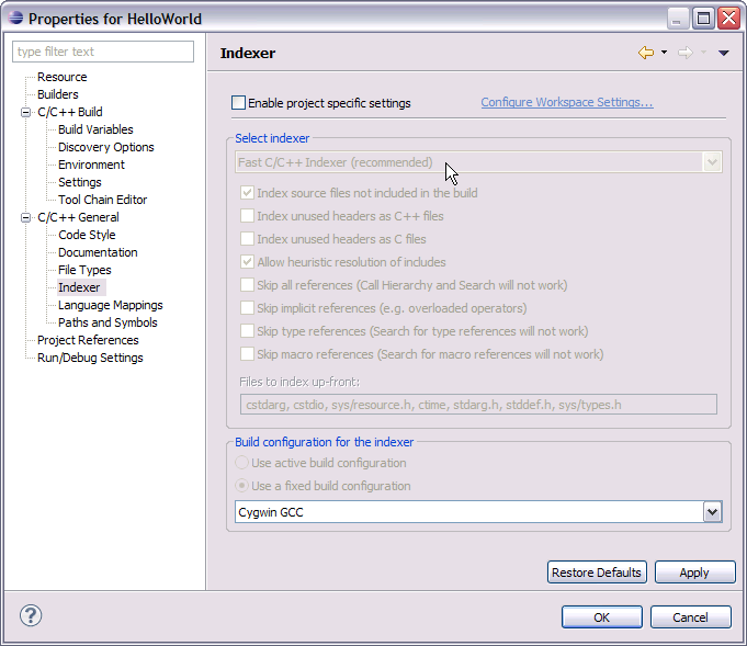

To change indexer settings, bring up the Indexer page in the Project Properties.Click here to see an illustration (displayed in a separate window).

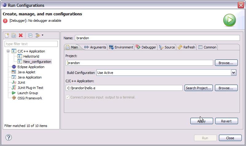

- To run your application within the C/C++ Perspective, click Run > Run Configurations...
The Run Configurations dialog displays.
- To create a run configuration, select C/C++ Application and click the New icon.
- Give your run configuration a name by entering a new name in the Name field at the top.
- On the Main tab, select the project by clicking Browse opposite the Project field.
- From the Project Selection window, select the project and click OK.
- Select the new C/C++ Application you want to execute by clicking Search.
In our case it didn't find the file because it's in a nonstandard location. Use the Browse button to select the executable. In our case also it's a nonstandard name,
hello.e
because that's what our makefilehello.mak
built.Click here to see an illustration (displayed in a separate window).
- If you see the error
[Debugger]: No debugger available
, select the Debugger tab and choose a valid debugger for your platform (e.g. gdb/mi).

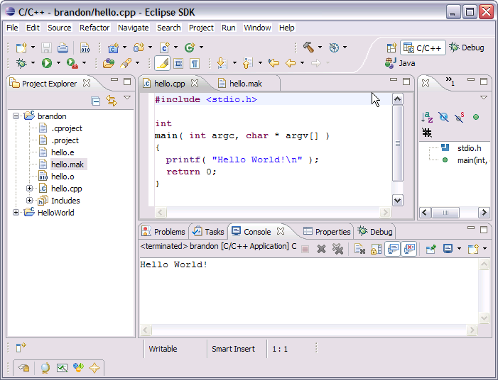

- Click Run to save the run configuration and run it.
The application runs in the Console view. The Console also shows which application it is currently running in the title bar. You can configure the view to display different elements, such as user input elements using different colors.
